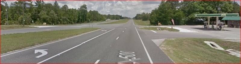

http://www.teslarati.com/witnesses-details-deadly-tesla-accident/
According to another witness that was driving eastbound on U.S. 27A – the same interstate [ that's a mistake- it's not interstate jh ]the Tesla was traveling on – the Model S on Autopilot passed her while she was driving at 85 mph. This detail not mentioned by the official police report filed by the Florida Highway Patrol provides further insight into why the deadly collision may have happened with the tractor trailer that turned before it.
That road is not interstate or even limited access though it is 4 lane divided.
