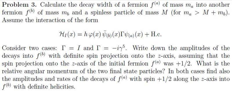

I've started from writing out the amplitude. Here I know that fermion has definite helicity so I can't sum over spins but I should input explicit forms of spinors. Am I correct? How to do this?
I would be grateful for helping me with this step. I'll manage the rest of the problem.
You insert the expression for a spinor of the appropriate spin. It should be described in your textbook how such a spinor looks.
