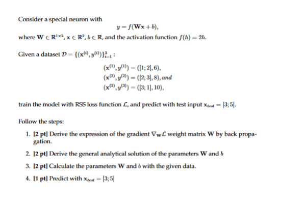

I have this equation which my professor has told me is correct so far.
##0 = -2*x^T(y-2(w*x+b))##

He told me to then augment w and b into one matrix in order to solve for both w and b.
How on earth do I do that?

The equation in your first post is somewhat confusing. ##w \cdot x## is a scalar and so wx+b is also a scalar leading to the conclusion that ##0## must be the zero row vector [0 0] ?
How is ##w*x## a scalar? x is a 2x1 matrix and w is a 1x2 matrix
I changed the formatting a bit so its easier to read
I see what youre implying. ##w*x## would be a scalar because it ends up being a 1x1 matrix. Youre correct.
All he told me was to set my equation to 0 and then solve for w and b. I then asked him how I solve for two unknown variables with only one equation and his reply was to augment w and b into one matrix.

I'm a bit confused by this. x is defined as a 2 x 1 column vector. In the first equation, ##x^T## would therefore have to be a 1 x 2 row vector. Is this correct?
It would be useful to see the actual problem description as given by your professor.
I am currently on part 3
After pestering him over and over about this he finally gave me this....
But now the problem Im running into is
is a singular matrix making
impossible
