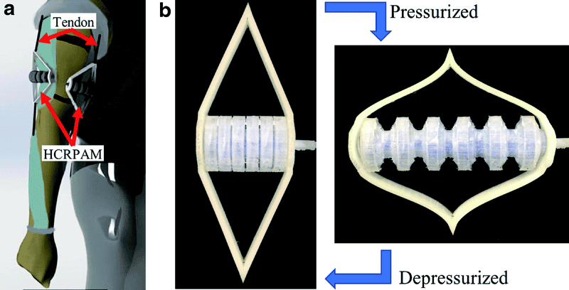

Well, I was trying to predict how much energy a pneumatic system would need in order to actuate in a specific force and speed, but it seems that I would need too little energy for too much work.
So, I was wondering how I would go on about making a pneumatic system with artificial muscles, they would essentially work like an horizontal pneumatic cylinder pushing against two ropes, simulating a contraction, but I don't know if I'm correct.
Source of image: "A Novel Soft Pneumatic Artificial Muscle with High-Contraction Ratio"

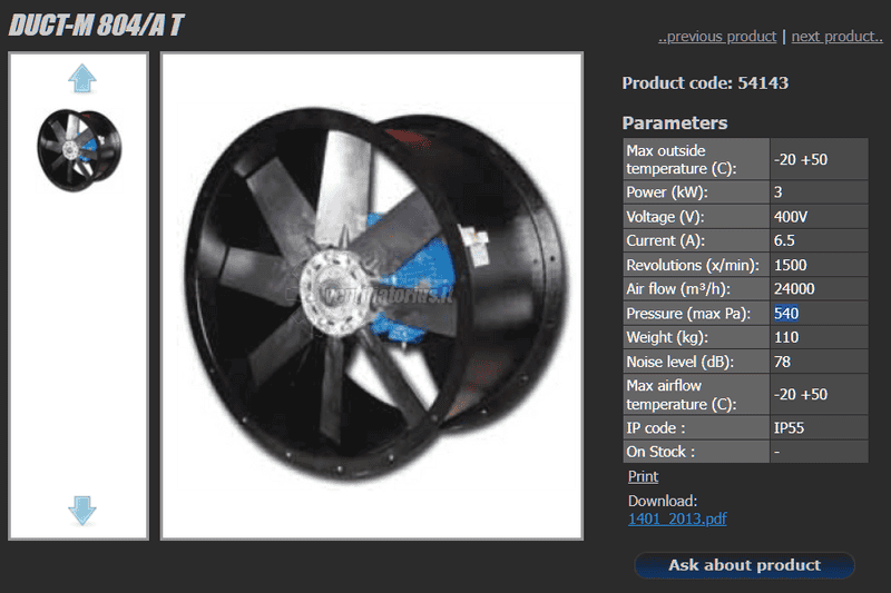

I found a data sheet of an 80cm wide industrial ducted fan that produces 400,000 liters per minute of airflow and 560 pascals of pressure at 3.3 kilowatts.
29,520,000 lpm / 400,000 lpm = 73.8
73.8 x 3.3 kilowatts = 243.54 kilowatts = 324.72 horsepower.
Since 0.1 bar = 10,000 pascals
10,000 / 560 = 17.8571428571 x 324.72 = 5,798.57 hp in total

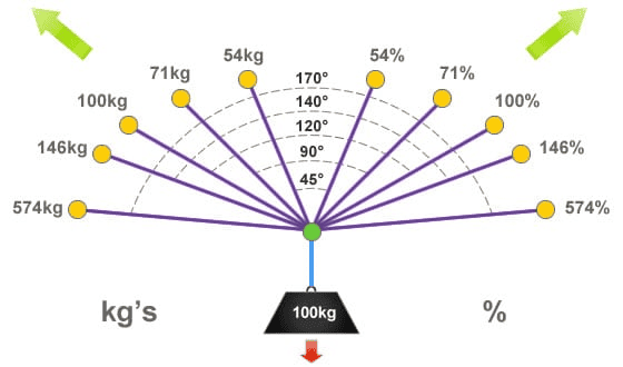

If you take the fact that ropes suffer 5 times more tensil strength around 170º degrees of angle, then you would need 5 times more energy:
5,798.57 x 5 = 28,992.8

Semi-independent actuators, Kinda like filament mckibben muscles.
Source: "Musculoskeletal lower-limb robot driven by multifilament muscles"
I tried to simplify the problem by calculating the muscles as horizontal cylinders and then making something like in the pic. making these big things into thin filaments.

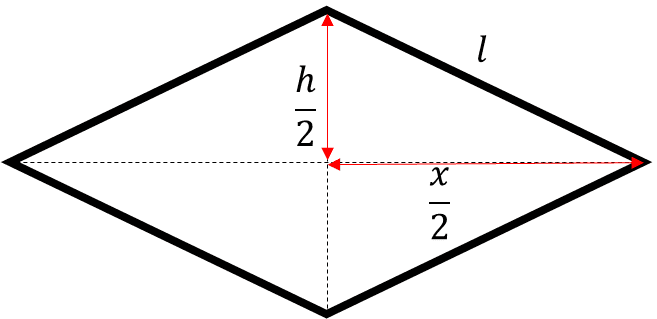

Considering the pneumatic cylinder, between two tensile filaments, as a structure that would need to be repeated many times in each fibre, at a minute scale, to get a magnified reduction in length. That assembly repetition needs to be simplified.
Now, if the ersatz muscle fibres, were soft silicone tubes, counter-wrap reinforced at between ±30° and ±45° with tensile filaments, then internal pressure would cause a shortening of the tube. Note that the hoop stress in a tube, due to internal pressure, is twice the extension stress between the ends, so hoop stress wins, and the filament restrained tube will become shorter, with a constant surface area.

Well, try with rigid bars to form the geometry first. You should be able to relate the desired output velocity of the bottom where ##F_{out}## is applied to the rate of extension of the pneumatic cylinder. All those forces and velocities determine the input power via the geometry of that mechanism
For instance, you could want to pull something vertically at constant velocity, the weight of that object times its velocity you desire is the desired output power (an underestimate if you account for accelerations to get to ##v##). It could end up being a bit of analysis, but you should be able to work your way through the linkage and relate that velocity to how fast the cylinder would need to extend. The forces needed to do that are a function of that.
You have an arm and its geometry to consider also, So its probably a bit challenging to link it all up, but you could just focus on the scissor jack mechanism for starters to get a handle on it.
You work with Pyhagorean, implicit differentiate, then integration to find ##x(t)## depending on what you demand for ##\dot h## (the velocity of the weight you are lifting). If ##\dot h## is a constant, then treat it as a constant. If you want it to be a function of time ##\dot h(t)## then treat it as such in the ensuing math. Keep your eyes on the prize; ultimately you want to find the velocity ##\dot x (t)## as a function of time, given you want the weight you are lifting has some desired ##\dot h(t)##. That is what leads you in the direction of the power ##P(t)## to complete such a task. What the task is needs to be defined before you can say how much power you need from the cylinder over the time of completing the task.

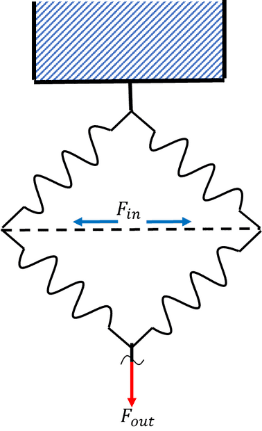

If you take the fact that ropes suffer 5 times more tensile strength around 170º degrees of angle, then you would need 5 times more energy:
Not really.
Energy or generated work remains about the same during the stroke.
As the cylinder expands and muscle contracts, the mechanical advantage of each dramatically changes.
Think of how the input force and output velocity of movement change when you use an automobile scissor jack to change a flat tire.

  • fan with 400,000 liters per minute with 560 pascals and 3.3 kilowatts
    10,000 pascals / 560 pascals = 17.8571428571
    3.3 kw x 17.8571428571 = 58.928 kilowatts
  • Since pneumatics needs to stay in equilibrium, I need to multiply it by 2
    58.928 x 2 = 117,856
  • 400,000 / 21,120 liters per minute = 18.9393939394 times less energy
  • 117,856 watts / 18.9393939394 times less energy = 6,222.7 watts
