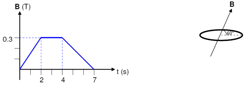

If i am given a graph of B(magnetic field) vs Time,how can i find the induce emf from this graph?? I know that the emf=-Nd∅/dt and ∅=BAcosθ but somehow i don't quiete arive to the right answer
Well, in BAcosθ, A and θ are kept constant, so EMF is -NAcosθ dB/dt. So what did you get for dB/dt?
