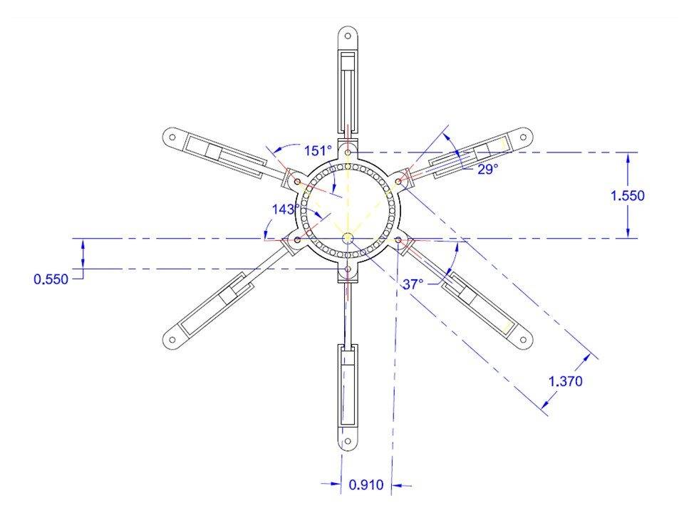

Baluncore, really appreciate your effort to accommodate my queries, but I still don't understand why my approach or how I understand it is different. I'm not an expert in Physics or Math so I really appreciate different inputs for my projects.
Scenario A: 4 cylinders, 90 deg. apart
Cylinder 1 (Clock Position 12) = 750mm distance between crankshaft center to the cylinder pin. Cylinder force is 180deg to the crankshaft so the Torque 1 is equal to 0.
Cylinder 2 (Clock Position 3) = approx. 500mm distance between crankshaft center to the cylinder pin, maximum force angle of the cylinder (from the alignment of crankshaft, pin, and cylinder), cylinder force is not tangent to the crankshaft so must consider Torque 3 = F x r x sin angle.
Cylinder 3 (Clock Position 6) = 250mm distance between crankshaft center to the cylinder pin. Cylinder force is 90deg to the crankshaft so the Torque 3 is equal to 0.
Cylinder 4 (Clock Position 9) = approx. 500mm distance between crankshaft center to the cylinder pin, maximum force angle of the cylinder (from the alignment of crankshaft, pin, and cylinder), cylinder force is not tangent to the crankshaft so must consider Torque 4 = F x r x sin angle.
Thank you Baluncore and to those who will contribute their knowledge or expertise in advance, your inputs will greatly contribute to the realization of my project.
  • Plan-view diagram of a six-cylinder radial hydraulic ram arrangement around a central crankshaft ring, with dimension callouts of 1.550, 0.550, 0.910 and 1.370 and angles of 151°, 143°, 37° and 29°.

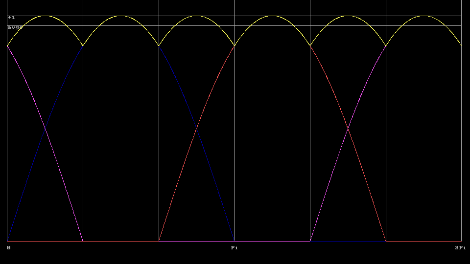

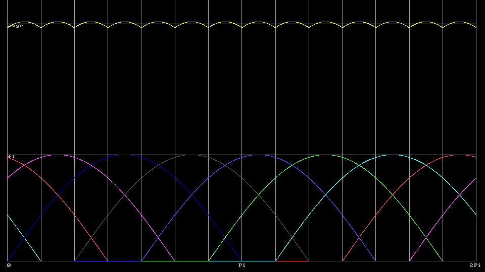

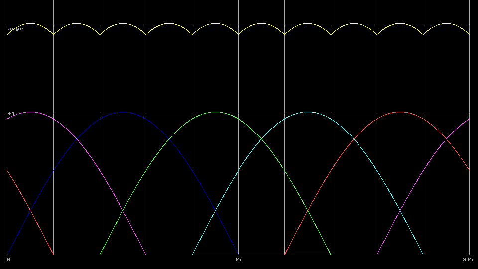

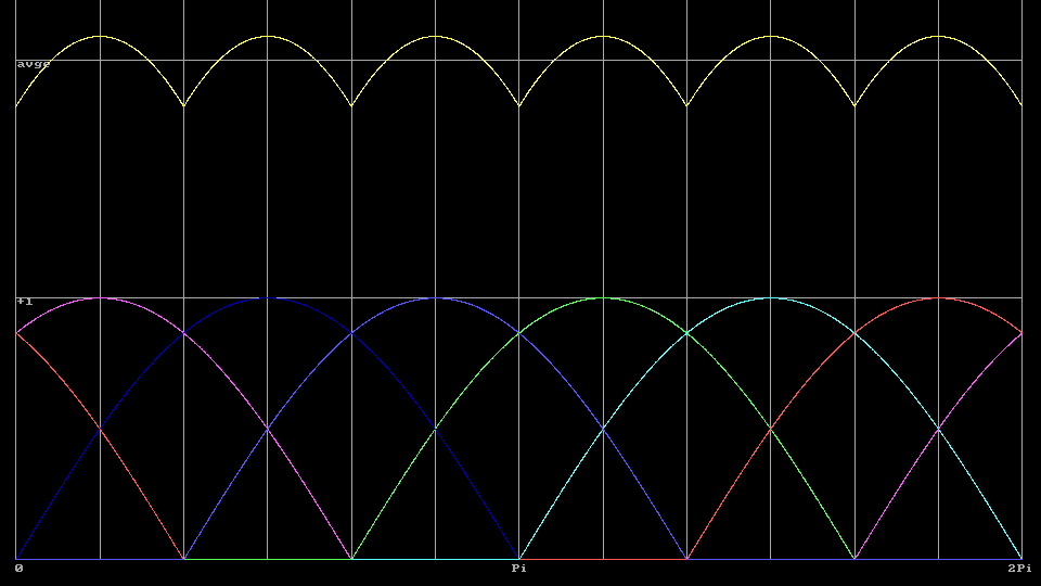

Why would you build a 4 cylinder pump when an even numbers of cylinders produces more variation in flow than an odd number of cylinders? The magnitude of the ripple is greater with a 4 cylinder pump than with a 3 or 5 cylinder pump. 32% compared with 14% or 5% respectively.
Each cylinder will pump on one stroke or 180° of the full cycle. At the end of the induction stroke, when the piston is at BDC, the inlet valve will close and fluid will begin to be pushed through the outlet valve. The fluid will reach a maximum flow rate 90° later and then fall back to zero flow at 180° = TDC. That flow rate is proportional to the positive slope of a sinewave, which makes the flow a half cosine wave.
With more than n = two cylinders, the flow from a number of cylinders may be combined at one time. The total fluid pumped per revolution will be the number of cylinders, n, multiplied by the capacity of one cylinder. The average flow rate will be n / Pi.
Code:
n    Min flow   Peak flow  n / Pi    Ripple %
3     0.8660     1.0000    0.9549    14.0298
4     1.0000     1.4142    1.2732    32.5323
5     1.5388     1.6180    1.5915     4.9758
6     1.7321     2.0000    1.9099    14.0298
7     2.1906     2.2470    2.2282     2.5284
8     2.4142     2.6131    2.5465     7.8113
9     2.8356     2.8794    2.8648     1.5270
10     3.0777     3.2361    3.1831     4.9758
11     3.4776     3.5133    3.5014     1.0213
Notice that the fundamental frequency ripple is canceled for odd n, but not for even n.
Attached are some graphs showing flow rates and ripple for 3 to 7 cylinders.
Graph of flow rate against angle from 0 to 2Pi for a multi-cylinder pump, showing overlapping half-cosine curves in yellow, blue, magenta and red with horizontal lines marked avg and +1.
3 cylinder
Graph of rectified sinusoidal flow curves over 0 to 2Pi, with an upper yellow curve labelled avge and multiple coloured half-cosine lobes showing four cylinders' combined flow output.
4 Cylinder
Plot of flow rate against angle from 0 to 2Pi for a multi-cylinder pump: a yellow combined flow curve with a ripple above several coloured half-cosine curves, one per cylinder, each peaking once per half cycle.
5 Cylinder
Graph of flow rate against angle from 0 to 2Pi for a multi-cylinder pump: a yellow top curve labelled avge shows a rippled average flow, and coloured half-cosine curves below are labelled Pi and 2Pi on the x-axis.
6 Cylinder

I believe you are being distracted by the slight variations in the angle of the cylinders. It is easier to start reasoning with the assumption that the cylinders remain at fixed phase angles.
If cylinder 2 is opposite cylinder 4, and both are pumping then you must be using the volume on both sides of the piston in both cylinders.
You have not yet specified the valve mechanism, nor have you shown the hydraulic connections to the cylinders, so it is still possible that you intend to use double acting cylinders that pump on both the extension and retraction stroke. If you do that you will have different cylinder capacity on either side of the piston due to the volume of the piston rod.
Your pump is similar to a radial aircraft engine. In that case the “big end” of the connecting rod was attached rigidly to one rod. That maintained the orientation of the big end as all other con-rods were pinned. It appears that radial engines always used an odd number of cylinders, usually 9.
I believe you should be considering 3 cylinders for your prototype. When that is working advance to 5 or 7 cylinders if there is an advantage in lower flow variation.
