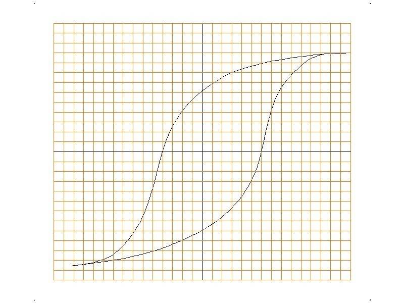

The area of hysteresis can be calculated using calculus, specifically through integration techniques. Users can apply numerical methods such as counting squares on graph paper, dividing the plot into slices, or utilizing advanced techniques like the Trapezium Rule, Simpson's Rule, and Gaussian Quadrature. For curve fitting, tools like MATLAB, Octave, and MathWorks' Curve Fitting Toolbox are recommended. Additionally, least squares regression can be employed to fit polynomials to data points for more accurate area calculations.
- Understanding of calculus and integration techniques
- Familiarity with numerical methods for area estimation
- Knowledge of curve fitting concepts and tools
- Basic understanding of hysteresis in systems, particularly in operational amplifiers
- Learn about the Trapezium Rule and Simpson's Rule for numerical integration
- Research MATLAB's Curve Fitting Toolbox for practical applications
- Study least squares regression for polynomial curve fitting
- Explore Gaussian Quadrature for efficient area calculations
