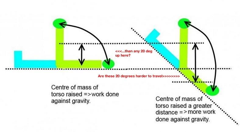

Ok perhaps I need to clarify. I am not a student, I am a curious person who a few days ago visited a museum where they had a house that was not flat, but rather inclined 20 degrees. So they take you through different rooms to show scenarios of what things change now that the house is inclined 20 degrees. They have a pool table and a table with chairs and the last room is a bedroom. They make you lie down on the bed and try to get up. Of course its impossible to get up from a -20 degree inclined bed.
I asked the guide what would be the physical concept that explained what changes from getting out of a normal bed vs this one with an incline? He was unable to explain it to me. So here I am, a 40 yr old adult who took physics but barely remembers anything anymore. So first let me clarify that I am not being lazy or cheating on my homework :-). I am simply trying to understand (without a high degree of mathematical precision) what changes when getting out of a flat be vs an inclined bed.
Yes of course the first thing I did was make a drawing and I posted it here at the beginning of the thread. The first thing I am trying to understand is simply, "why is it harder to get up out of the inclined bed"? Does the force needed to lift a weight at an angle increase? Or is the force the same but the work required different because that body is being lifted through a greater amount of degrees (-20 -> 90 vs 0 -> 90)? Or what, if anything else, is making it more difficult to get out of the inclined bed?
To be honest I got even more confused thinking that perhaps the force is still the same but the angle makes it more difficult. Then I realized I wasnt really clear about my concepts. So its not so much that I am interested in the exact mathematical calculation. I would like to start by first understanding what is making the "getting up" more difficult.

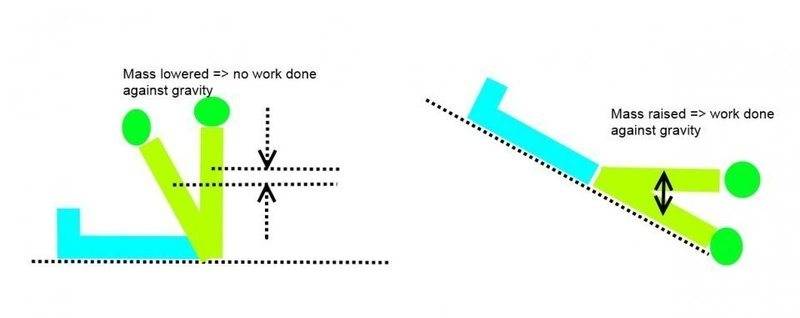

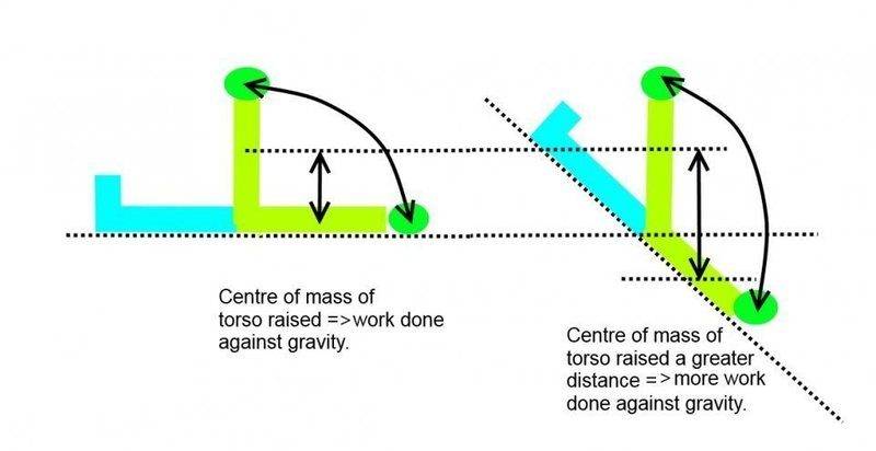

marciokoko said:.. intuition tells me it can't just be that, because if the bed were flat, sitting up the torso from a flat 0 degrees to 90 and then 20 degrees more towards the feet, is not as hard.
Your intuition is wrong. These two situations are not the same.
In the first the "extra" 20 degrees is from -20 to 0 (horizontal). The centre of mass of the torso is being raised so you are doing work against gravity.
In the second the "extra" 20 degrees is from 90 (vertical) to 110. The centre of mass of the torso ends up lower as you bend forward so you are doing no work against gravity. (aside: It still takes some effort because you have to compress your stomach etc.)
It's not just the extra angle that matters. It's where that extra angle occurs.

marciokoko said:Thanks CWatters. So you would say that in the first scenario you make 90 degrees against gravity but in the second you make in 110 degrees against gravity?
Looks like I am confusing you.
There are two ways to calculate the work done...
1) Work = force * displacement
In this case "displacement" is the vertical displacement of the centre of mass. It's different for the 90 and 110 cases due to basic geometry. Force is the weight of the upper torso which is a constant depending on your mass.
2) Work = torque * angular displacement
In this case "angular displacement" is (the radian equivalent of) 90 or 110 degrees. The problem is that Torque is not constant, it's also dependent on the weight of the upper torso but it also varies with the angle making the maths harder.
The two methods give the same answer but 1) is probably easier to understand and calculate.
With the above you can calculate the work done against gravity and that should account for most of the difference between 110 and 90 degrees.
It's interesting to note that if you do a sit up and then lay back down the net displacement is zero as your torso is back where it started. So the net work done is zero. However it sure doesn't feel like you have done no work. What happened is that you do work against gravity on the way up and gravity does work on you on the way back down. It's just hard luck that humans have no way to collect and store the energy that gravity does on you. It ends up being wasted.
