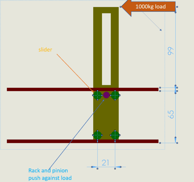

hello I am trying to calculate the force applied on the sliders in that sketch
it is a level wind system for winch
I am not an engineer but as much as i understend
the 1000kg load is 10000kn becose it is 1m from the top slider
the sliders at te top are 20 cm apert so the load will be 50000 kn on the slider if it was only slider at the top
but i don't know how the load ditrubot to the bottom sliders and between them
ill be very thenkful if someone can explain it to me in simpel way or add link to videos in that sobject
thanks

It's a little unclear how that load is being applied. 1000Kg represents a mass, which would normally present a downward force. But you have it in an arrow pointing to the left.
So one of these things are happening:
The olive colored part of the slider is being accelerate to the right of left while carrying that load. But you have not specified any such acceleration or movement.
Either left is the downward direction, or force of a 1000Kg mass in 1G of gravity is being applied to the top of the slider in the direction indicated.
You need to tell us which. In the meantime, I will assume the latter: 10,000KN of force is applied in direction indicated by the arrow.
At this point you will need to label your parts. I am going to call the four green wheel Wa and Wb (incontact with the top slide bar and the sprocket) and Wc and Wd (in contact with the lower slide bar) - with Wa and Wc on the left and Wb and Wd on the right.
Let the horizontal axis be the x-axis and vertical the y-axis. So your 10MN force is (-10,0)MN.
The olive colored bar is resisting this force through its contact with Wb (which can apply force in both x and y) and Wc (which can apply force along the y-axis only).
But to continue the analysis, you will need to specify:
the thickness of the top brown slide bar
the diameter of the green wheels.
Also: At this point you need to start showing us some more of your own effort on analyzing this.

for the calculation the distance from the center of wb to the top of the olive part is 1m
I add the size of the wheels
and the force is a result of the rack and pinion pushing against a cable that blocks the olive part in the right side
i add sum calculation that i learn in youtube but :
i don't know how to take in consideration the force of rack and pinion (i have to add it again or not)
and i am not sure that i am in the right direction at all with that calculation
thank you very much
alik
When analyzing the resulting reactions from the load you can simply discard the upper left and lower right wheels because all of the load vertical moment will be carried by the upper right and lower left two diagonal wheels. Approximately 1656 kg of horizontal loading will be experienced by the pinon gear with it effectively acting as the pivot for vertical forces on the two affected wheels; each of which, will experience approximately 4714 kg vertical loading on their axles and resulting in an approximate 9428 kg separating force between the upper and lower guide rails due to the load moment, . In addition, the unit's weight load, which is divided equally between the bottom two wheels, must be added to the lower left wheel load given above. The values given are close to the actual loadings but I use the term approximate because the limited dimensions given in the diagrams prevents a completely accurate analysis. The toque experienced by the pinion shaft depends upon the radius of the pinion gear.
