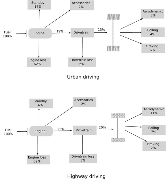

Hello everyone!
i am traying to understan how my car spend the gasoline. First of all, i supoused that the main way that my car spend energy is when it have to brake the inerce. for example, when you are in a traffic ligth, you are at 0 km/h and you have to acelérate to be at 40 km/h. that is easy to calculate whit the cinetic energy equation.
But for my surprise, this energy is very low, my results were that whit 1 liter of gasoline, you can brake to 0km/h and acelerate to 40 km/h, by 60 times, its crazy.(i supused that the efficience of my engine to convert the energy of the gasoline is 20%).
After of that, i think in the wind resistance. I have make the calculous and for a velocity of 40 km/h whit a good shape car, the energy is even lower that the before case.
I dont know if i am makeing a mistake, or if i cant recognise a important force.
pd: im from Argentina, im not a good english speaker, i hope that you can understand me :)
good week!

Hi Dave! thanks for replay!
of course. To the first analysis, i used DEc=1/2 * m * (Vf^2-Vi^2). to the mass, i estimated 2000kg, inicial velocity to 0 and final velocity to 40 km/h (11.1 m/s). Then i setched the specific energy of gasoline (34.78 MJ/Lt) and aplyed the engine efficience (20%). With all, i can found how many liters ofc gasoline i need to move my car from 0 to 40 km/h. the result of it is liters to move mi car= 0.0177L (if you multiplicate it for 60 times, you will got 1 liter aproximaly)
To de air resistance analysis, i used Fd=1/2 * Cd * p * v^2 * A. i supose to my car move at 40 km/h for 100 m. i considered that Cd = 0.31 (my car is similar to toyota corolla), p(air density)=1.2 kg/m3 , A=1.9 m2 (i take the heigth and width and multiply them). whit this i calculated the resistance force, and then whit W=F*x i calculated the work of the force along the 100m. the result of it is W=-4320 J
i think that because to go to my work, i have 10km by city, so i probably do the action of break and acelerate 60 times. i have calculated how many liters of gasoline my car spend, and with one liter i can do 12 km aproximaly

Please, see:
https://es.m.wikipedia.org/wiki/Economía_de_combustible_en_automóviles
https://en.m.wikipedia.org/wiki/Fuel_economy_in_automobiles#Energy_considerations
