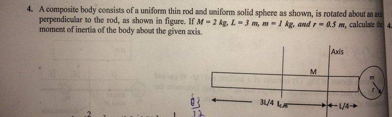

1. The problem statement, all variables and given/known
See attachment , it only gives me length of rod and it's mass and radius of sphere and its mass and the place of the axis
I=mr^2
I tried to get the moment of intertia of rod by integration from -L/4 to 3L/4 , but i cannot get the intertia of sphere around the axis ,

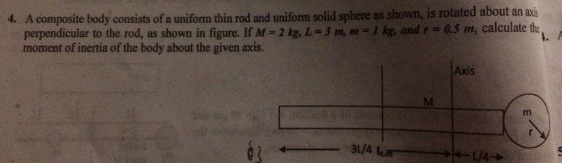

Can you post a better image please? That one is way too dark to read...

You should not need to do any integration. For such a question, I would expect to be allowed to quote standard formulas for moments about mass centres and apply the parallel axis theorem.
by this equation ( Inertia at axis =Inertia at axis from centre of mass + mass*distance between the two axis^2 ) ??
Yes.
haruspex said:
Yes.
Thank you for telling me the way of parallel axis theorem i wasn't know it , my physics professor in university didn't tell us anything about it and he puts it in an exam
That's quite an omission. All good now?
Yeah , thank you so much.
