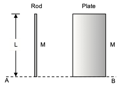

The figure below shows a rod of length ##L## and mass ##M##. Next to it is a plate of height ##L## and mass also ##M##. The two objects are very thin in the direction into the screen. The moment of inertia of the rod about the dotted line AB is ##I_{\text{rod}}=\frac{1}{3}ML^2.##
What is the moment of inertia of the plate about the same axis?

You can think of the plate as a lot of rods in parallel. Their moments of inertia, about the same axis, add up, just like their masses do.
