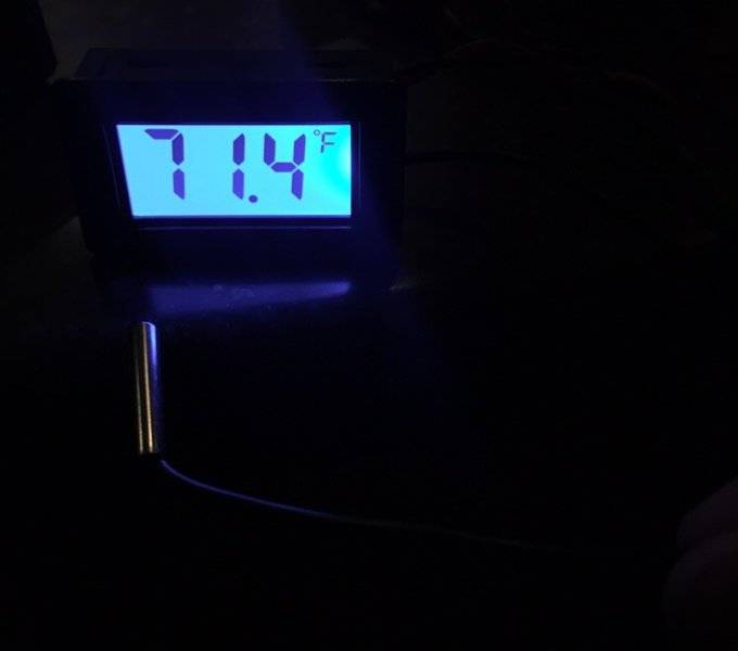

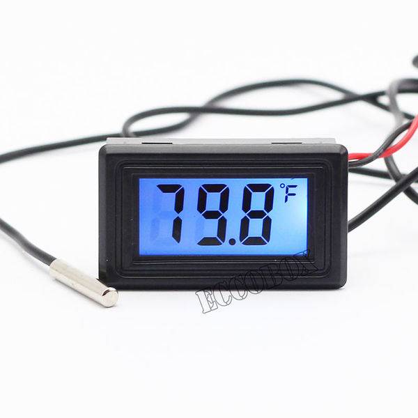

An item I want to buy comes backlit blue and I need it to be GREEN. I contacted the seller and asked if I could change the bulb color with a green bulb condom and asked if it was currently a clear led, with a blue cover. THey said yes, but later they then wrote me back saying they made a mistake and the led inside doesn't have a cover, and an actual BLUE LED.
If I put a yellow bulb cover overtop the blue led, would it make it green?

It's not likely you can change the color of that display. White LEDs are more expensive than single-color LEDs, so it's unlikely they would use them in their display. Instead, just look for another display with the desired backlight color.
I've looked everywhere for weeks and there are none like this in green. THis is the size and color I want. It's just a single led that's lighting the screen. What can I just put a rubber yellow bulb condom over it, or remove and put in a green one?

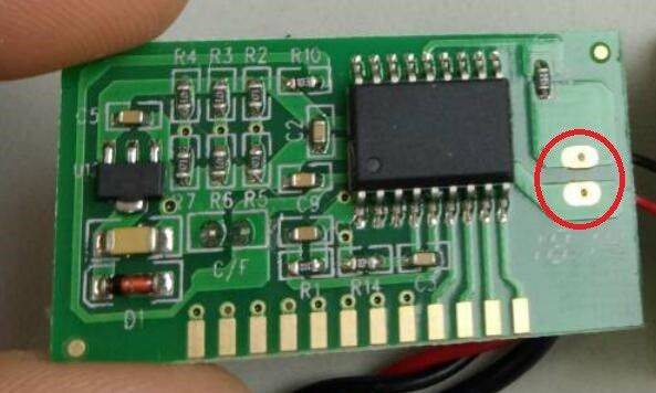

Ok, the seller was able to show me a picture of the board... The red circle are the leds. Crap, I wonder how hard to change to green led?

Seems like standard 3mm through-hole LED mount. You need to take the soldering iron, take out the blue LED and replace with green one, without any cap.
Note with an LED, there is a + lead and a minus lead. It will only light up if it is installed with the correct polarity.

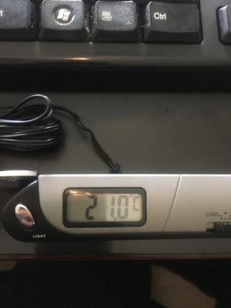

Thanks. I actually saw that one, but it won't work as that one is C - celsius as most are, and i need the degress in F. This is being used in a car. Below are pics of the OLD SETUP.

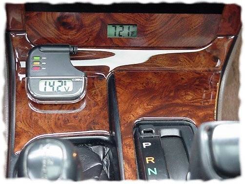

This is the old unit above, Worked for 10 years. Ran off 1 AAA battery, and a friend helped out and found a resistor to make it work off 12v... It has a green backlight (hard to see in this day pic) and everything is green backlit in the vehicle, dash, radio, volts, etc, and wants to stick with green theme. I found the same silver unit again, as shown above and bought 3 of them for backups but they don't work correctly, as the outside looks the same, but the inside circuit boards changed and the green backlight turns off after 5 seconds not matter what I try inside, which is pointless at night...
SO, that's why I'm onto the new one I found, and I've looked for weeks for something that will fit in the hole I made out of the plastic veneer wood, but the blue will... I'm not that smart to figure out how to get the old one to work as there are a few new capacitors on the board of the older silver unit, again where the green light only stays on for 5 sec. Before, I soldered two leads together and the light would stay on all the time constant, but these updated ones I bought... I can't stop the light from tuning off after 5 sec... Again, this is why I wanted to try a new solution, and the new blue one will fit, but I just need it GREEN.

A little late, but I don't think just putting something yellow over / in front of a blue LED will work.
LEDs have a pretty narrow spectrum.
Filtering it through yellow will get you pretty close to ... black.

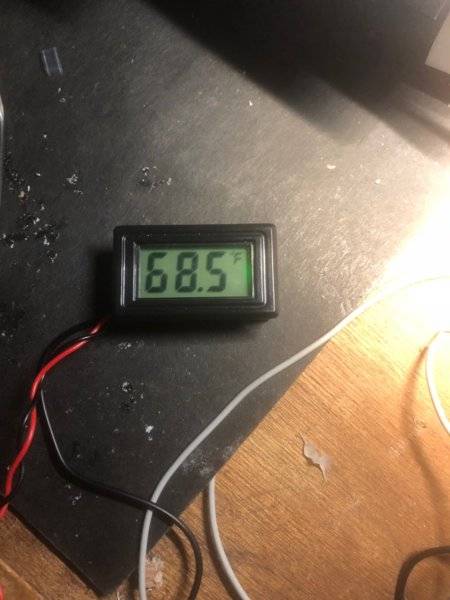

Just wanted to update. I got the unit and it fits in the old location that I posted above in the vehicle :) It fits perfect which in kinda unreal since that hole was custom sized with a file by me 10 years ago, got lucky I guess...
Now just got to figure out how to get it green led. Maybe someone knows what leds to buy or would anyone want to help me out with this project? I'm in PA.

Ok. So. Confused again. As shown abovein my earlier post, the manufacturer sent pics of the circuit board before I ordered this and circled the leds supposedly on this board in red, see above posts. I just took the unit apart and I don’t see any leds on the board? I powered it up and they look like they are part of the lcd display and are embedded in the lcd? Am I right? Confused here. Below is pic of board and lcd I twisted off to the side.

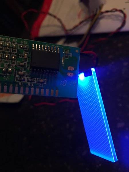

I see. This is the "LED backlight module" intended to reduce light losses of LED. It can still work with discrete LED, although with complications. You need to:
1) Cut the existing LED clear from diffusor plate using knife or heavy-duty nail cutter.
2) Either use "right angle" packaged LED, or bend leads of your LED to look sideways into diffusor panel
3) Connect LED lens and diffusor plate with a drop of transparent acrylic or silicone adhesive (recommended)

NO! Do not use a nail cutter.[/color] The hard plastic of the diffuser will crack. Use a hobby knife such as an X-Acto, or similar. Using the tip of the blade, make shallow cut strokes on the surface until you get thru the hard plastic. Carefully, like you are doing surgery on your finger.

Well, you may have tried to cut used diffuser. I suspect some embrittlement by light happens. New one is more easy to handle, i had in one case even drilled 4mm mounting holes in diffuser. Although about knife you correct - my preferred tool for cutting materials like diffusers or rigid PVC is 30-degree cutter similar to X-Acto.

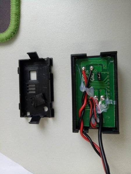

Is that for a backup led? Could I disconnect those side leds and put one led in the red circle? Lol. Why on Earth did they say that's where the leds go? And Tthere are two total leds in this, one at end end of the lcd glass...
I'd like to try this myself but I'll probably destroy it. As my father would say "Custom items just cause problems" LOL, well, the original unit lasted 10 years with a resistor to converted to 12v so that was a good run. As mentioned I can still buy the original unit but the circuitry changed and not sure how to get that orignal backlight to stay lit but someone here could prob figure it out (the silver unit that I had originally)

The question is, how are the LCD and current backlight module bonded? Are they bonded, or does the module simply fit behind the LCD panel?

From engineering standpoint, likely maker at first used stand-alone LED. Afterwards, they moved to SMT LED integral to diffuser, and interfaced it to the existing PCBs layout, either to consume stock of old PCBs or to save on PCB development.
Actually LED position is not that important - some light will go to diffuser anyway, regardless of location. Brightness may suffer though.

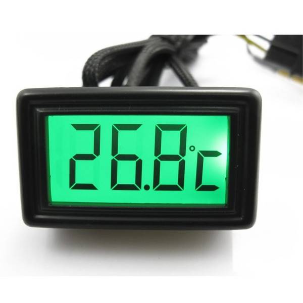

Ok, now I saw this! Exactly what I want... BUT! Looks like this is only C, when I need it to display in F, and it shows 5v, where the blue one on ebay shows 5-25v. I'm using for 12v. Argh, don't think it will work? but this is what I want it to look like 100%
https://www.overclockers.co.uk/xspc-lcd-temperature-display-green-v3-flat-sensor-wc-206-xs.html
Regarding temperature units (C or F), not much can be done without reprogramming firmware, which is not really feasible unless you are maker of thermometer. Regarding voltage range, most LCD units (as opposed to LED 7-segment) have stable enough supply current so you can adjust input voltage using ballast resistor or 2-3 LEDs in series in power supply line.

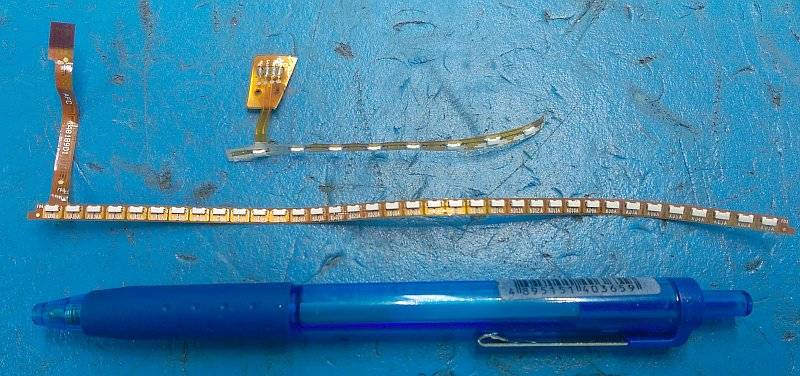

they are generally just a strip of individual LEDs non-bonded, just held in place with the panel casing ...
I pull dozens of these apart to get the LED strips for other projects
here's 2 different strips from two different sized LCD panels I pulled apart
Dave
