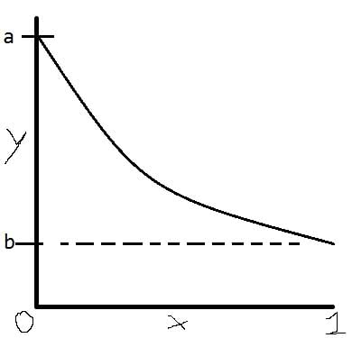

I'm programming a camera for a game, and to achieve some effect I think the best solution would be some kind of function.
What I need to achieve, is a function that:
- 'starts' at x1, with a y value of y1.
- 'ends' at x2, with a y value of y2.
- I also need some parameter to control the 'curve amount' of the graph in between x1 and x2
('starts' and 'ends' mean that only the solution for the set of x values ['start' - 'end'] matter)
Unfortunately my calculus knowledge is very limited so I hope that someone here could explain to me what the correct solution is, and/or how to get there.

So, we are going to pick three points on this curve and find a quadratic polynomial that fits these data. A quadratic has the form:
p(x)=a_2x^2 + a_1x + a_0
and we want to find a quadratic such that:
p(x_i) = y_i, i = 1,2,3
that is, we have three equatations in three unknowns. The unknowns are the a_i, i = 1,2,3. Now, just solve this system for the three unknows, and you will have your polynomial. Also, you can pick a 4th point and construct a cubic polynomial in a similar manner. In general, if you pick n points, you can construct an (n-1)th degree polynomial that fits those points.

update:
I've found a 2nd degree polynomial that goes through 3 points.
x=0.0, y=1.0
x=0.3, y=0.3
x=1.0, y=0.0
Solved: ((40/21)*((x)^(2)))-((61/21)*(x))+1
(check http://www.freemathhelp.com/equation-grapher.html )
But this is not what I want because it's going under the x-axis instead of making a smooth curve. I think I'll use a bezier curve instead :)

I think the problem as stated is slightly ill-defined. Do you only want that shape on a bounded subset, or does the function need to have a horizontal asymptote as x goes to infinity?
I'm not sure what a bounded subset is, but I certainly don't want an asymptote. The problem is slightly ill defined because I don't have much knowledge about calc + I'm not used to expressing math terms in English. But I hope you can get a 'feel' for what I want to achieve?
Anyway, I solved the problem with bezier curve now, still it would be nice to know how to do it with 'normal' polynomials.
I'll try to define better how I want to define the curve:
There should be three points making up the curve:
P1 (starting point)
P3 (end point)
P2, Length(P1,P2) = Length(P2,P3) (mid point)
You should be able to 'move' P2 around on a line that is perpendicular to [P1,P3], and goes through the point .5*(P1+P3)

When he said asymptote I think he meant f(x)->0 as x -> infinity, like what's happening on your graph.
The bounded subset just means that you're only interested in the values of x between p1 and p3. :smile:
My idea about the lagrange polynomials would be able to do that!
The lagrange polynomials are handy little polynomials.
Let x1,x2,x3 be the x coordinates of p1,p2,p3 and y1,y2,y3 the y coordinates, then you can make 3 poynomials, which give zero at two of the three points and the value 1 at the other, like this;
P_1 (x1) = 1 , P_1 (x2) = P_1 (x3)=0
P_2 (x2) = 1 , P_2 (x1) = P_2 (x3)=0
P_3 (x3) = 1 , P_3 (x1) = P_3 (x2)=0
To make this work you'd just have
P_1(x) = \frac{(x-x2)(x-x3)}{(x1-x2)(x1-x3)}
P_2(x) = \frac{(x-x1)(x-x3)}{(x2-x1)(x2-x3)}
P_3(x) = \frac{(x-x1)(x-x2)}{(x3-x1)(x3-x2)}
I hope you can see that these will give the values I gave earlier, so to be able to do what you want (what I think you want at least) you define your f(x,a), where a defines the y value at x2;
f(x,a) = y_1 P_1(x) + a P_2(x) + y_3 P_3(x)
Using the properties of the polynomials you can easily verify that this will give you the desired results.
Is this the kind of thing you are looking for?
I think so, yes. Thanks
