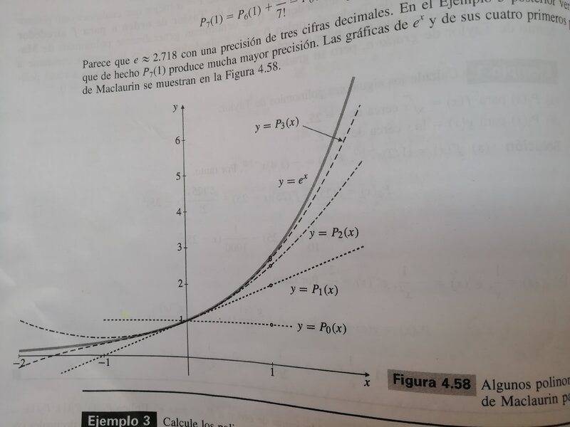

Hi, PF
For example, ##\sin{x}=O(x)## as ##x\rightarrow{0}## because ##|\sin{x}|\leq{|x|}## near 0. This fits textbook definition; easy, I think.
But, Taylor's Theorem says that if ##f^{(n+1)}(t)## exists on an interval containing ##a## and ##x##, and if ##P_{n}## is the ##n##th-order Taylor polynomial for ##f## at ##a##, then, as ##x\rightarrow{a}##,
$$f(x)=P_{n}(x)+O\Big({(x-a)^{n+1}}\Big)$$
and "this is a statement about how rapidly the graph of the Taylor polynomial ##P_{n}(x)## aproaches that of ##f(x)## as ##x\rightarrow{a}##; the vertical distance between the graphs decreases as fast as ##|x-a|^{n+1}##.
Italic words is what I don't understand
My attempt is somehow to restrict it to one example: MacLaurin polynomial for ##e^x##:
$$e^x=1+x+\dfrac{x^2}{2!}+\dfrac{x^3}{3!}+\ldots{+\dfrac{x^n}{n!}+O(x^{n+1})}$$
Why the graph decreases as fast as ##|x|^{n+1}##?
Thanks! Hope LaTeX is right and message is understandable (post without preview, sorry).
Sorry, I just got it: I must only substitute ##x## and ##n## ... Well, let's see, suppose ...If I look at the graph, and I want to know the value of ##e^{1}## for ##P_{4}##, I get the sequence, I mean, the Maclaurin formula with errors in Big-O form...Let me think it over, sleep on it.:sleep:
Hi PF, working on it. I think must make an effort I haven't made still.
Greetings

mcastillo356 said:
Taylor's Theorem says that if ##f^{(n+1)}(t)## exists on an interval containing ##a## and ##x##, and if ##P_{n}## is the ##n##th-order Taylor polynomial for ##f## at ##a##, then, as ##x\rightarrow{a}##,##f(x)=P_{n}(x)+O((x-a)^{n+1})##
This is a statement about how rapidly the graph of the Taylor polynomial ##P_{n}(x)## approaches that of ##f(x)## as ##x\rightarrow{a}##; the vertical distance between the graphs decreases as fast as ##|x-a|^{n+1}##.
I don't understand this quote. My attempt:
##f(x)-P_{n}(x)=O\Big(|x-a|^{n+1}\Big)##. On the right side there is the error term, the rapidness Taylor's polynomial approaches to ##f(x)##, and third:
$$|f(x)-P_{n}(x)|\leq{k|x-a|^{n+1}}$$
That means it exists a constant ##k## such that the distance between the function and the Taylor polynomial is bounded by a multiple of the function ##|x-a|^{n+1}##. I can't help watching these three approaches as something not compatible, although I know it must be.
Hi, PF
$$f(x)-P_{n}(x)=O\Big(|x-a|^{n+1}\Big)\Rightarrow{|f(x)-P_{n}(x)|\leq{k|x-a|^{n+1}}}$$
If there exists a constant ##k## bounding ##|f(x)-P_{n}(x)|## by ##|x-a|^{n+1}##, we've got an order of approximation; this means an expression for how accurate the Taylor polynomial comes near to a function. Don't you think talking about accuracy is more precise than rapidlity?
No, I think there must be some linguistic confusion. You are looking at two sides of the same coin and thinking it must be a different coin.
Because ## f(x)=P_{n}(x)+O((x-a)^{n+1}) \iff |f(x)-P_{n}(x)|\leq{k|x-a|^{n+1}} ## we can talk about accuracy and rapidity interchangeably.
It is a three sides coin:wink:, error, rapidity or accuracy, and order of approximation
