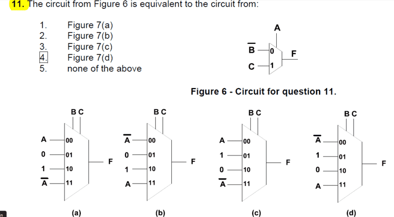

Can anyone help me with this question?
I got the equation of the 2to 1 MUX. I got F = A'B' + AC. But the problem is I am not sure how to convert this into 4:1 MUX.
Any help will be appreciated.
Thanks

Write the equations for each 4:1 MUX and see which one is the same...
ohh yea got it thanks a lot.
