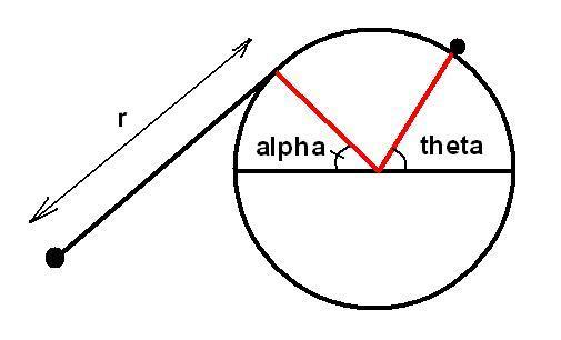

Find the equation of motion, see diagram. Masses are P1 2m and P2 3m.

Does what I have done look ok? The string is a model string so [tex]\texttt{T}_1=-\texttt{T}_2[/tex]. How can I find [tex]\texttt{N}[/tex] and [tex]\texttt{T}[/tex]?

Let's consider the problem in general case. P2 swings (and maybe goes up or down) and thus, the section connected to P2 in general is not in vertical position. Therefore, in general, the angle coordinate of P2 is not theta.
I suggest a way to look at the problem, though I'm not sure if it's an easy way. The system's position is described by 3 coordinates: theta for P1, alpha and r for P2.
EDIT: I'm sorry, 2 coordinates are enough: theta and either alpha or r.

The system is initially at rest with P1 at B. P2 hangs vertically below A.
For P2 should I be using rectangular components instead of polar.James
Okay, so that's much easier. Then the equation for P2 is: [tex]3mg - T = 3m\ddot{y}[/tex]
We also have this: [tex]y=R\theta[/tex]
Therefore, [tex]3mg - T = 3mR\ddot{\theta }[/tex] (1)
We also have 2 equations for P1:
[tex]2mR \ddot{\theta }=T-2mgcos \theta[/tex] (2)
[tex]2mR \dot{\theta }^2=2mgsin \theta - N[/tex] (3)
From (1) and (2), get rid of T and do the integration, you will have [tex]\dot{\theta }(\theta )[/tex]. Combine with (3), you should have [tex]N(\theta )[/tex].
Actually if you apply the energy conservation law, things are much easier :smile:

Yes, that's the easiest way to analyze P2's motion. In this problem particularly, you even only need 1 coordinate (either x or y) for P2.
