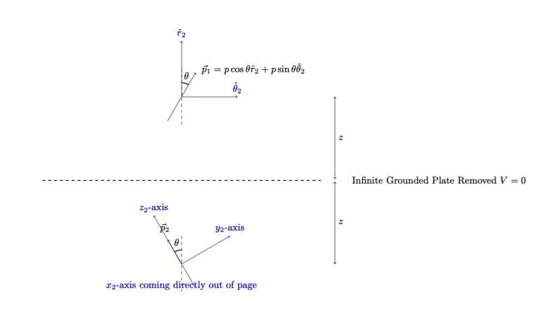

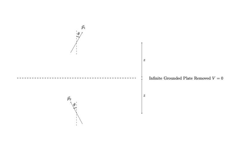

The correct image configuration that mimics (Figure 1) is shown below.....that is to say it maintains the boundary conditions. I'd imagine the torque that the grounded sheet exerts on the real dipole is the same as the torque the image dipole exerts on the real dipole. I want to calculate everything in the frame where the image dipole ##\vec{p}_2## is aligned along the ##z-\text{axis}##. Let's call it ##z_2## so as now to confuse it with the distance from the plate to the real dipole. The frame is included in the figure below.
Where of course ##\vec{p}_1## and ##\vec{p}_2## have the same magnitude. Might as well call it ##p##.
(Figure 2)
Diagram of two dipoles on opposite sides of a dashed horizontal line, with p1 above and p2 below, each tilted by angle theta from a vertical dashed line. A vertical double arrow labelled z marks each side of the line, with the label Infinite Grounded Plate Removed V = 0 on the right.
I'd like to compute all of it in the local spherical vector basis of ##\vec{p}_2## at the location of ##\vec{p}_1##.
I contend that according to the picture below that ##\vec{p}_1 = p \cos \theta \hat{r}_2 + p \sin \theta \hat{\theta}_2##
(Figure 3)
Diagram of a dipole above a dashed plane with its image dipole below, showing axes r2, theta2 and z2, angle theta, distance z to the plane, and the formula p1 = p cos theta r2 + p sin theta theta2.
and ##\vec{E}_2## at the location of ##\vec{p}_1## is of course
##\vec{E}_{2} = \frac{1}{4 \pi \epsilon_0 (2z)^3} \left( 2 \cos \theta \hat{r}_2 + \sin \theta \hat{\theta}_2 \right)##
So
##\vec{E}_{2} = \frac{1}{32 \pi \epsilon_0 z^3} \left( 2 \cos \theta \hat{r}_2 + \sin \theta \hat{\theta}_2 \right)##
Take the cross product ##\vec{N}_1 = \vec{p}_1 \times \vec{E}_2##
##\vec{N}_1 = \frac{p^2}{32 \pi \epsilon_0 z^3} \left( \cos \theta \hat{r}_2 + \sin \theta \hat{\theta}_2 \right) \times \left( 2 \cos \theta \hat{r}_2 + \sin \theta \hat{\theta}_2 \right)= -\frac{p^2}{ 32 \pi \epsilon_0 z^3} \left( \sin \theta \cos \theta \right) \hat{\phi}_2##
Using double angle identity for ##\sin 2 \theta = 2 \sin \theta \cos \theta## we get
So ##\vec{N}_1 = -\frac{p^2}{ 64 \pi \epsilon_0 z^3} \left( \sin 2 \theta \right) \hat{\phi}_2## which is into the page as expected using the right hand rule.
I think this answer is right.
My guess for finding equilibrium orientations would be to set the torque equal to 0 which is weird because we'd get that ##\theta = 0## and ##\theta = \frac{\pi}{2}## and I don't think that either aligns or anti-aligns with the field from the pictures drawn above.

Why would the dipole come to rest? Are we assuming that the dipole undergoes underdamped harmonic motion because of some dissipative force? If so, and if the point dipole is constrained to a fixed height above the plane, then its equilibrium orientation should be at ##\theta =0.## You can see that because the low energy configuration of the dipole and its image is "ferromagnetic."
Your figures for ##\vec p_2## look wrong. It should be a true reflection of ##\vec p_1##, with the arrow pointing down and right, not up and left.
Edit: Forget that, I'm wrong.

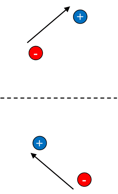

Two diagrams separated by a dashed horizontal line, each showing a red circle marked minus and a blue circle marked plus joined by a black arrow; the top arrow points from the red charge toward the blue charge, and the bottom arrow points from the red charge toward the blue charge in the mirrored position.
The arrowheads are hard to read but I think the picture is correct. If you consider the dipole as two point charges separated by some distance, the image charges will appear in the reflected position with a change of sign (see figure on the right.) The dipole moment points along the separation distance from negative to positive charge.
