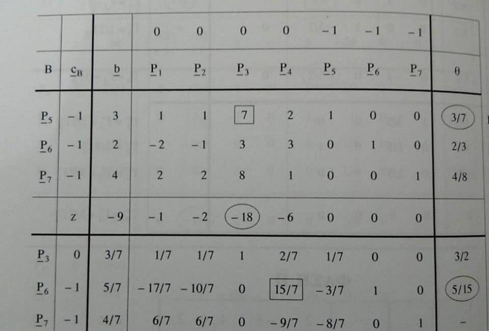

I think that we have to use the the two-phase method.
We introduce artificial variables:
$$- \max (-5x_1+10x_2-7x_3+3x_4) \\ x_1+x_2+7x_3+2x_4+x_5=3 \\ -2x_1-x_2+3x_3+3x_4+x_6=2 \\ 2x_1+2x_2+8x_3+x_4+x_7=4 \\ x_i \geq 0, i=1,2, \dots, 7$$
At the first phase, we solve the linear programming problem $\min (x_5+x_6+x_7)$ under the new restrictions and at the second phase the initial problem, for which we will have found from the first phase a basic feasible solution.
Then I thought that the initial simplex tableau of the first phase would be the following:$\begin{matrix}
B & c_B & b & P_1 & P_2 & P_3 & P_4 & P_5 & P_6 & P_7 & \theta & \\
P_5 & -1 & 3 & 1 & 1 & 7 & 2 & 1 & 0 & 0 & & L_1\\
P_6 & -1 & 2 & -2 & -1 & 3 & 3 & 0 & 1 & 0 & & L_2\\
P_7 & -1 & 4 & 2 & 2 & 8 & 1 & 0 & 0 & 1 & & L_3\\
& z & 0 & 0 & 0 & 0 & 0 & 1 & 1 & 1 & & L_4
\end{matrix}$But I found that the following is the initial tableau. How do we get the $z_k-c_k$ values?
