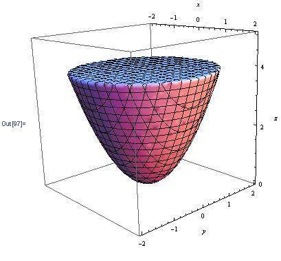

Thank you DaleSpam, now I can draw integrals in rectangular coordinates, for example, the integral
RegionPlot3D[-2 < x < 2 && -\[Sqrt](4 - x^2) < y < \[Sqrt](4 - x^2) && x^2 + y^2 < z < 4, {x, -2, 2}, {y, -2, 2}, {z, 0, 5}, PlotPoints -> 50, Mesh -> True, AxesLabel -> Automatic]
will draw

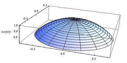

but for spherical coordinates, I found the sentence SphericalPlot3D, which for example with
SphericalPlot3D[{1}, {\[Phi], 0, Pi/4}, {\[Theta], 0, 2 Pi}]
will draw

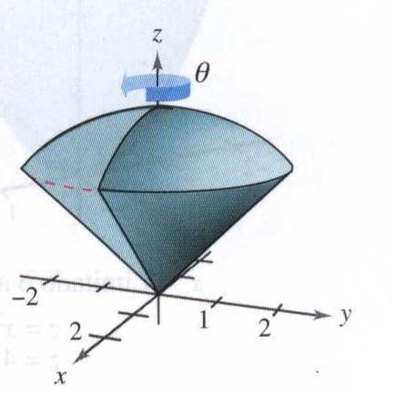

but I doesn't draw the cone underneath the sphere, my question is, is there a way to do that?

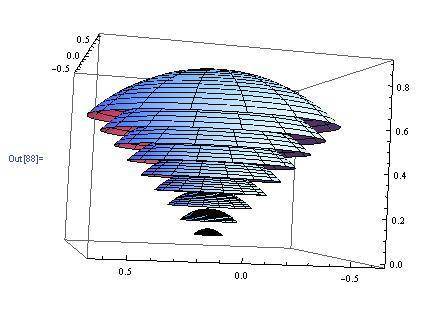

I thought something like saying to mathematica "draw me rho from 0 to 1 continuously ", and it would draw
, but the cone being solid
thank you
