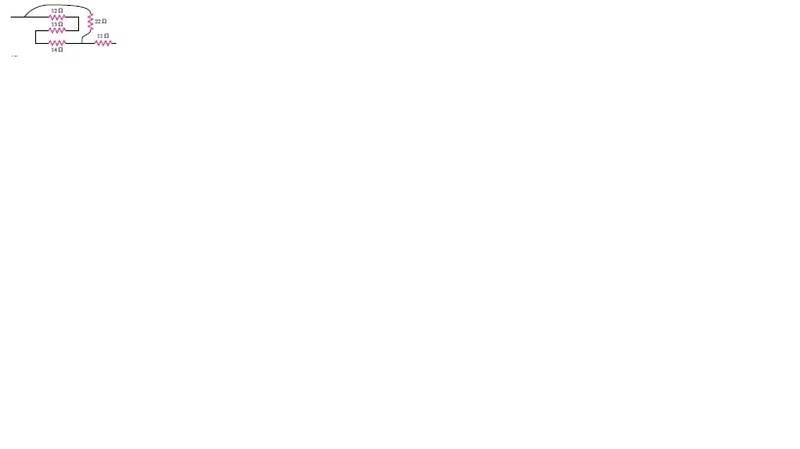

With 12V battery,I had simplified the look and found the I.total= 0.47874. I need to find the Current and Voltage in all the resistors. I understand the 11 ohms has I=0.47874 and V=5.28V.
Then remaining voltage goes to the parallel ones, so the 12 ohms has V=6.72V and I=0.3061A , then the remaining amps go to the other side which are in series and are the same? with different voltages?
I see your diagram as being so tiny as to be unreadable even though it is in a SPACE that is quite large.
