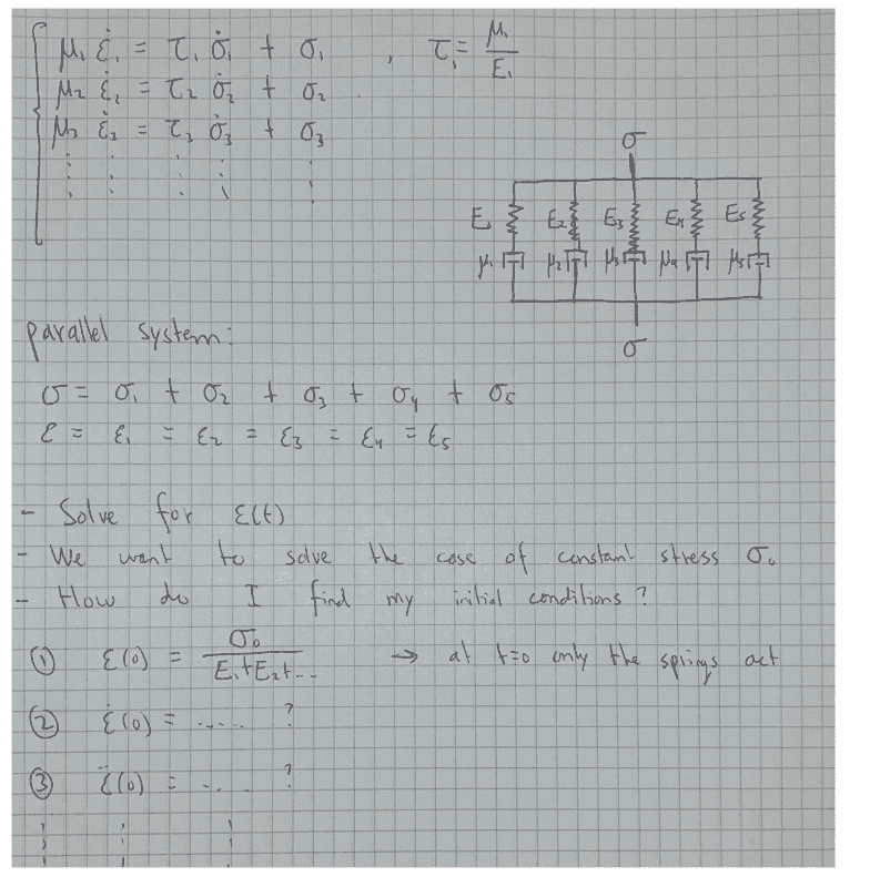

Hello,
I am trying to solve a differential equation corresponding to a visco-elastic material model consisting of 5 units of springs and dashpots connected in parallel as can be seen in the image below. I am able to come-up with a single fifth order ODE, however I am struggling to find the initial conditions for t=0. The differential equation is solved for epsilon(t) and is subject to a constant stress sigma_0. I am able to come-up with the first initial condition as can be seen in the image but I don't know how to find the remaining 4 conditions. Please help!

Finding the general solution to the problem is not the issue here. I am able to formulate the general solution to the problem, but then i am left with 5 unknown constants which can be solved using the initial conditions. However formulating these initial conditions is the thing I am struggling with. So far I only found one initial conditions as can be seen in the image. Does this clarify my question?

The following document provides some background to what I am trying to model. Specifically on page 20-22 a problem similar to mine is evaluated. There two Maxwell units in parallel are used. I am trying to use five units.
http://homepages.engineering.auckla...scoelasticity/10_Viscoelasticity_Complete.pdf
I don't see a fifth order ODE at all, but instead five first order ODEs -- assuming ##\sigma## is the input1 and ##\varepsilon## is to be found2. They can be added up to one first order ODE. Please enlighten me if I am wrong ? (And I think I am... :cool: )

(Gee, it's a drag to quote from a picture -- ##\LaTeX## is soooo much better... )
Anyway with that you have established ##{\dot\epsilon}_0 = 0## and also that ##\dot\sigma_0 = 0## -- I think.

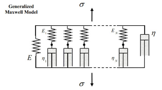

Strange: page 20 (302) is already further:10.3b Retardation and Relaxation spectra.
But 10.3.6 Generalized Models on page 300 has a picture like the one in your post #1:
with a warning that
"Piaras Kelly: Solid Mechanics Part I: An Introduction to Solid Mechanics" said:
