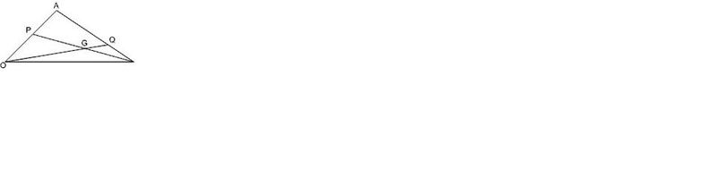

Given that:
OA = 5s
OB = 10 t
P is on the middle of OA and AQ = 3 QB
Find λ if BG = λ BP
basic vector
I have found AB, BQ, OQ, BP; all in terms of s and t. How to find λ? I've tried but always came back to equation BP = BP or 0 = 0. Please give me hint to start

Yes, the third vertex is B. This is my work:
AB = AO + OB = -5 s + 10 t
Sorry I didn't explain it clearly. I didn't find the length but I found the vector.
BQ = 1/4 BA = 1/4 (5s - 10t)
OQ = OA + AQ = 5 s + 3/4 (10t - 5s) = 5/4 (6t + s)
BP = BO + OP = -10t + 5/2 s
By the way, the value of λ should be 2/5. Thanks

That looks to be a good start. Now, let OG=μ OQ, then OQ = OA + AQ and after some algebra work. OQ = 5/4 s + 30/4 t
BG = λ [5/2 s - 10t ]
OG + GB = OB
5/4 μs + 30/4 μt + 10 λt - 5/2 λs = 10t and by comparing...
30/4 μ + 10 λ = 10 --- 1
5/4 μ -5/2 λ =0 ---2
Now you are left to solve the simultaneous equations. :smile:Hope that helps.
Ah damn, didn't think about elimination.
Thanks. That helps a lot
