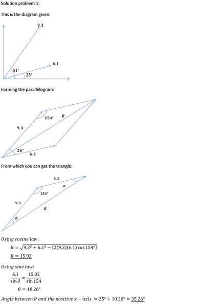

How to find the angle between the resultant and the X axis?

I don't understand. Doesn't the diagram show you exactly how to do it? :confused:
Use algebra to isolate sin( \theta) then apply arcsin.
The answer is wrong.

Can you please elaborate?
No, 10.26 degrees is correct.

Solve for sin(theta) from the equation that you get from the sine law. Once you know sin(theta), then you know theta, because you can apply the inverse sine (a.k.a. arcsine) on your calculator just as Integral mentioned.

The computer keeps say it's wrong.
Yeah and i keep getting 10.16.

Can you post your calculation steps? Maybe we can see where you went wrong.

15.02/sin(154)
= 34.2632
6.1/34.2632
= .1780
Sin^- .1780 = 10.26
10.26 + 25 = 35.26 as my final answer
deaninator is correct; the answer is wrong.
Break the vectors down to their x- and y-components and solve it that way. You'll see that the resultant vector makes an angle of 40.75^\circ[/tex] with the x axis.<br /> <br /> The problem stems from the fact that the wrong angle is being found in the attachment. The angle you need to find is the one <i>below</i> the resultant vector, not the one above.<br /> <br /> Using the sine law, you would find this angle by:<br /> <br /> \frac{9.3}{sin \theta} = \frac{15.02}{sin 154^\circ}

<br /> <br /> then you add 25 degrees right?

Yes.
25 degrees is the angle between the positive x-axis and the vector on the bottom of the parallelogram (the 6.1 magnitude vector).
\theta[/tex] is the angle between that vector and the resultant vector.<br /> <br /> The sum of the 2 angles is the angle between the resultant and the x-axis.

Alternatively, they found the right angle but added it to the wrong angle. They should have calculated 51 degrees less 10.26 degrees = 40.74 degrees. (The reason they didn't get 40.75 degrees is because that 10.26 degrees should be 10.25 degrees.)

Can you tell me how you got to to 40.74 please?
Referring back to the diagrams in the attachment, you found the angle \theta[/tex] to be 10.26^\circ[/tex]&lt;br /&gt; &lt;br /&gt; That is the angle between the 9.3 magnitude vector (from the first diagram) and the resultant vector R. (Note that the angle between the 6.1 magnitude vector and the resultant vector is not the same.)&lt;br /&gt; &lt;br /&gt; Since the 9.3 magnitude vector makes an angle of 51^\circ[/tex] with the x-axis and the resultant vector is &amp;lt;i&amp;gt;between&amp;lt;/i&amp;gt; that vector and the x-axis, then the resultant vector is 10.26^\circ[/tex] &amp;amp;lt;i&amp;amp;gt;closer&amp;amp;lt;/i&amp;amp;gt; to the x-axis. Therefore the resultant vector makes an angle of 51^\circ[/tex] - 10.26^\circ[/tex] = 40.74^\circ[/tex] with the x-axis.
