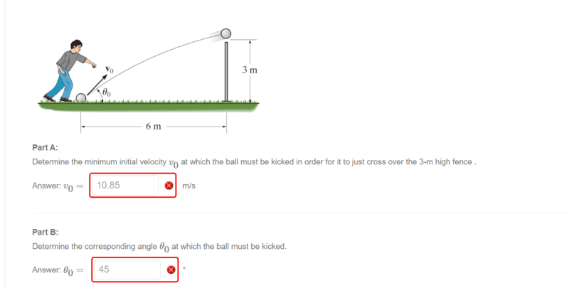

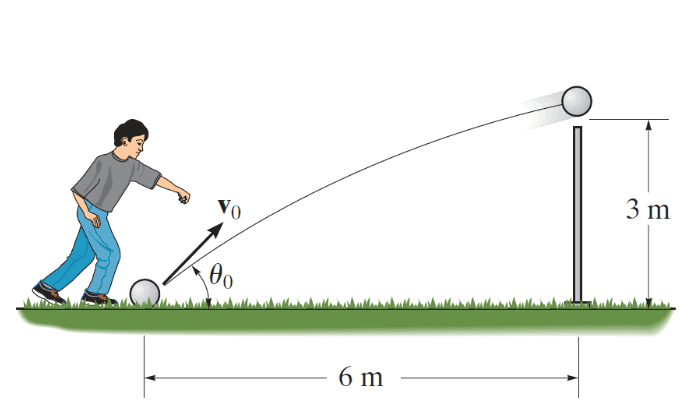

Determine the minimum initial velocity v0 at which the ball must be kicked in order for it to just cross over the 3-m high fence .
Part B:
Determine the corresponding angle ##\theta _0## at which the ball must be kicked.
kinematic eqs for constant acceleration
Hello there, I don't understand what I'm doing wrong I don't get the correct answer, but have done the same analysis 3x already and still get the same...
Some input would be appreciated thanks in advance.
Note: y-axis is upwards and x-axis is to the right.
3 unkowns i.e. 3eqs.
##x = x_0 + v_{0,x}t##
##6 = v_0cos\theta * t (1)##
##y = y_0 + v_{0,y}t + \frac 12 a_ct^2##
## 3 = v_0sin\theta * t - \frac12 gt^2 (2)##
##v_y = v_{0,y} - gt##
##0 = v_0cos\theta - gt (3)##
##(3) in (2)## --> ##3 = gt^2 - \frac 12 gt^2##
##\frac 12 gt^2 = 3## --> ##t = \sqrt{\frac 6g} = 0.7821s##
##\frac {(3)}{(1)} --> \frac {v_0sin\theta}{v_0cos\theta * t} = \frac {gt}{6}##
##tan\theta = \frac {gt^2}{6}##
##\theta = atan\frac {gt^2}{6}##
##\theta = 45## degrees --> WRONG
using these result in ##(1)##:
##v_0 = \frac {6}{cos\theta * t} = 10.85m/s## --> also WRONG because of the angle of course.
Thanks in advance.
Why do you think ##45^\circ## is wrong?
euhh because that is what I got as an answer? pulling the intial velocity and angle AND the time as unkowns through he equations
oh @Orodruin because I know the final answers, that is why :)
Well, ##45^\circ## is obviously correct just based on how a parabola looks.
just as I thought.. but the answers convey a different story unfortunately..
##v_0 = 9.76m/s## and ##\theta = 58.3## degrees

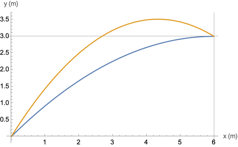

I think the minimization of the initial velocity was missed?
You need to write ##v## as a function of ##\theta##, with parameters ##x,y##. Then you need to minimize ##v## using standard optimization techniques from calculus to solve for the angle that minimizes the velocity.
You can reason this out by picking some angle, and initial velocity and see if it makes it over the fence. If you keep decreasing the initial velocity while holding the angle constant, at some point it won't make it over the fence. You have found the minimum velocity that makes it over the fence for the angle you have chosen. Now increase or decrease that chosen angle and repeat process until you find the overall minimum initial velocity (over the set of all valid launch angles). This is basically what the calculus I described above does for you.
Orodruin said:
Your solution is not wrong. At least not for the angle as shown in #9. I have not looked at the initial velocity part.
To be more clear. Your solution is the solution that just crosses over the fence when obtaining its maximum height. In order for this to be the minimum velocity required you would need to show that this is indeed the solution that gives the minimal velocity, which you have not argued for.
Edit: Yes, reaching a larger height at any point would require a higher velocity in the y-direction, but it will also require less velocity in the x-direction as the ball will have more time to travel the same x-distance.

The OP's main problem is assuming that the vertical velocity when passing the fence is zero. If you make this assumption, then the required angle is indeed 45 degrees, but that situation does not correspond to the minimal velocity to pass the fence.
