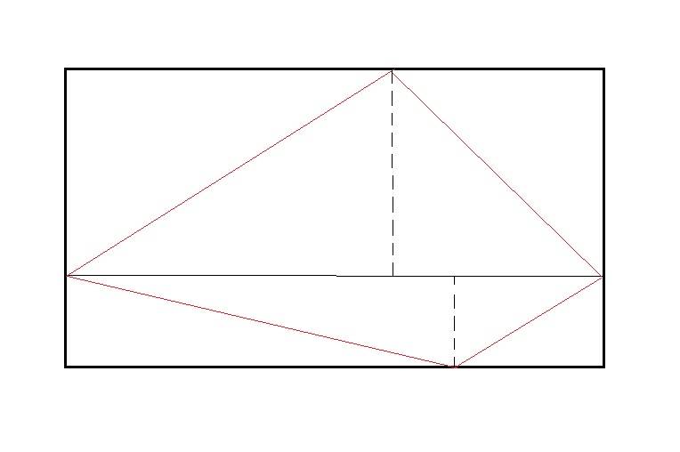

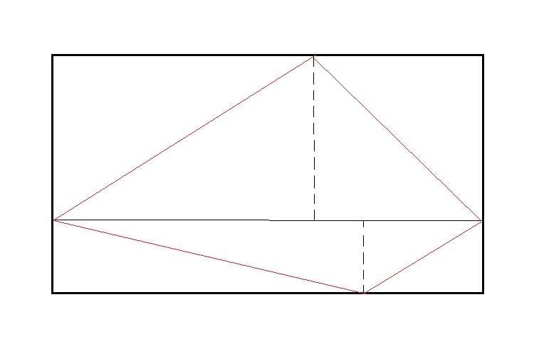

Max area also 2A ... ?
  • Diagram of a quadrilateral with red sides inscribed in a black rectangle, its vertices touching the left and right sides and the top and bottom edges; dashed vertical lines drop from the top vertex and the bottom vertex to a horizontal black diagonal.

Hello,
I computed $\sin{\theta}=\frac{2A}{pq}$ . Now what is the next step? Which answer would you choose from the answers a,b,c,d,e,f given by author(#4) as correct answer? and why?
You'll need the $$\phi$$ later.
Next step: you need to express the sides of the rectangle in terms of the diagonals and some variable you have to introduce for that.
I try to add a picture a bit later. Need to figure out first how it's done...

Let's define the circumscribing quadrilateral has area $$A_c$$, and now we have obtained:
$$A_c(\alpha) = pq\cos \alpha \cdot \sin (\phi - \alpha)$$.
Now it's time to use the 3rd tip in my first post: the derivative. We must find the angle $$\alpha$$ such that $$A_c(\alpha)$$ has a maximum. So:
What is $$\frac{\mathrm{d}A_c(\alpha)}{\mathrm{d}\alpha}$$?

The angles are labeled differently than in the picture we posted a couple of posts ago.
In particular we have:
$$\theta_{new}=\frac\pi 2 - \beta_{old} \\ \alpha_{new} = \phi_{old} \\$$
In that picture the sides of the circumscribed rectangle have the same length as A'C' and B'D'.
We have:
$$A'C' = AC \cos\beta_{old} = p\cos(\frac\pi 2 - \theta_{new}) = p\sin\theta_{new} \\
B'D' = BC\cos\alpha_{old} = q\cos(\frac\pi 2-\phi_{old}-\beta_{old}) = q\cos(\theta_{new}-\alpha_{new})$$
