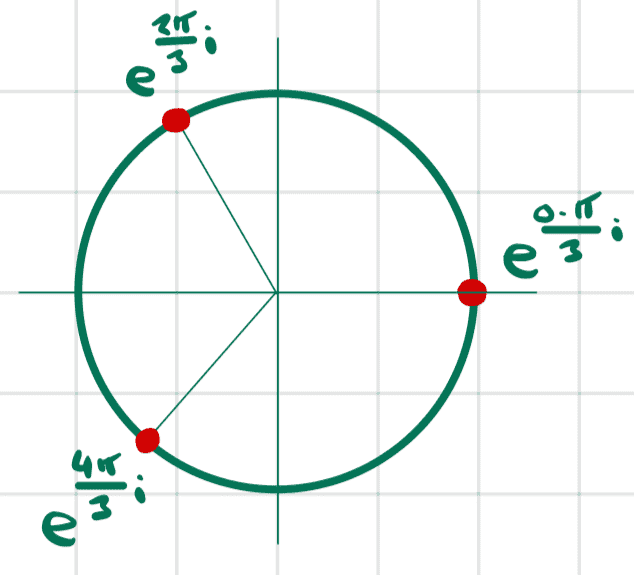

Visually what is the n=0,1,2 doing for
$$x=5^{1/3}e^{\frac{2\pi}{3}ni}\tag{2}$$
in the complex plane?
What does ##{2\pi}/3## equate to in degrees?
These are also the three cube roots of the number 1. We multiply by ##5^{1/3}## to get the cube roots of ##5##.
My next question was going to be about something I read here.
Namely, that to solve ##z^n=c=re^{i\theta}## we can find one solution ##r^{1/n}e^{i\theta/n}## and then find all solutions by multiplying by the solutions to ##z^n=1##.
The link seems to imply we can choose any one solution to then multiply by the solutions to the n-th roots of ##1##.
Indeed, after checking this method for ##z^3=5## it does indeed work.
So basically, it seems that to solve ##z^n=c## we can take the real solution ##c^{1/n}## and multiply it by the ##n## ##n##-th roots of unity.
