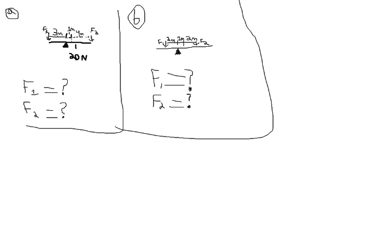

Just getting back into physics in college and am stuck on this problem. I don't even remember how to start it let alone finish it. Help would be appretiated.
Need to find the forces of each end and the beam is to be balanced.
Find the forces F1 and F2 that are in the positions shown, then move to the second positions and find F1 and F2 again. Lever weighs 20N
Figures are shown with horrible paint skills, sorry about that.
A) (3/8)20N= 7.5N for the left force exerted by the beam
(5/8)20N= 12.5N for the right side of the beam
So far left side= 7.5N and right side= 12.5N
So does that mean F1(applied)=12.5N-7.5N=5N ? and then F2(applied)= 0N
Is it that it or am I missing something obvious

This problem is confusing in the way it is being asked. Besides the forces F1 and F2, there must also be an upward force (call it U) exerted on the beam at the pivot point. So that is 3 unknown quantities in the problem.
But we can only write 2 equations to describe the lever being balanced: (1) the forces' (vector) sum is zero, and (2) the torques sum to zero.
It seems there is another piece of information needed to solve this, or I do not understand the description correctly. Does the problem statement say anything else about the forces F1 and F2?
