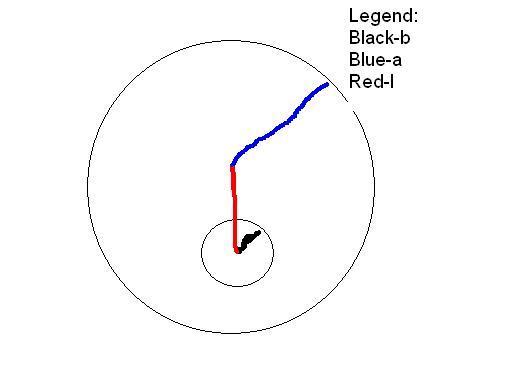

Hello, let me dish out the particulars straight away:
"A large(and infinite) cylinder of the radius a, is fed a Current I through its surface; the same current, but traveling in the opposite direction exits the body through a smaller cylinder located within the greater one, and at a distance l from the center of the former, with the radius b(also infinite, both axes are parallel).
Find the magnetic force of interaction:(Per unit length)"(Also see the attached diagram):
Well, we would have to start with the Amperian Force:
[tex]\vec{F}=I\int d \vec{B} \times \vec{l}[/tex]
[tex]\frac{\partial \vec{F}}{\partial l} = I \int d \vec{B}[/tex]
And of course, (and I assume there's no reason to prove it), the field of an infinite current, passing through a wire is:
[tex]B = \frac{{\mu}_0I}{2 \pi r}[/tex] (r- being the radial distance from the current).
Well, I've tried separating the current through some sort of surface distribution, i.e:
[tex]dI'=\frac{I \cdot dS}{\pi (b^2-a^2)}[/tex], but as you might imagine, I've been rather unsuccessful, this where the resolution of this question jams; That is, after multiplying by B and then integrating over the remaining dr there, I am firstly uncertain as to how to set up the boundaries of the integral, and then, I receive a logarithm, an unlikely relation(decrement), in problems of such kind.(More so, it doesn't match the advertised solution).
What should I do next?
I thank you for you time and attention,
Hoping for your aid,
Thanks!
Daniel

The question doesn't really make it clear how the current flows over the surface of each cylinder. Is it flowing parallel to the axis of the cylinder, or around its circumference?
Hi again,
If not sufficiently lucidly stated in the phraseology of the question itself, the current flows parallel to the axes of both cylinders, that is, the same value enters the larger one, and leaves, in the opposite direction(but still parallel, as always), through the smaller one; There's no need to reiterate that both are insulated from one another.
What's next then?
Thank you very much again,
Daniel

danielakkerma said:
Hi,
If you mean that the current curls around the cylinders, then I beg to differ.
No, I mean the magnetic field curls around the cylinders, not the current.
The magnetic field therefore, outside the cylinder is 0
Not if the current is flowing along the length of the cylinders (parallel to their axes). Why do you think otherwise?
How do you propose then, to compute, via Biot-Savart's (if it applies), or Ampere-Maxwell's law, the proper the magnetic field, as you say?
Think of each cylinder of being made up of an infinite number of thin (thickness [itex]ds[/itex] ), long straight wires, carrying current [itex]i = I\frac{ds}{2\pi a}[/itex] for the larger cylinder or [itex]i = I\frac{ds}{2\pi b}[/itex] for the smaller cylinder. You know that the field of each wire is [itex]\frac{\mu_0 i}{2\pi d}[/itex], where [itex]d[/itex] is the distance from the wire and it circles around the wire (right-hand rule). Integrate over the circumference of the cylinder to get the total field.

You're forgetting that the magnetic field is a vector, you need to account for the direction of the field of each thin wire. The field from each wire points in a different direction and you will need to account for that when you integrate.
Hey,
Wouldn't you say though, that since [tex]\vec{B} \ \ || \ \ (\hat{I} \times \hat{r})[/tex], that in our coordinate system, the resultant will always be pointed in the [tex]\hat{z}[/tex] direction?
If not, what angle should I incorporate?
Thanks again,
Daniel
danielakkerma said:
Hey,
No, the current is flowing in the z-direction (parallel to the axis of the cylinder, right?), so the resultant B will be perpendicular to the z-axis. (just as it is for each long straight wire)
