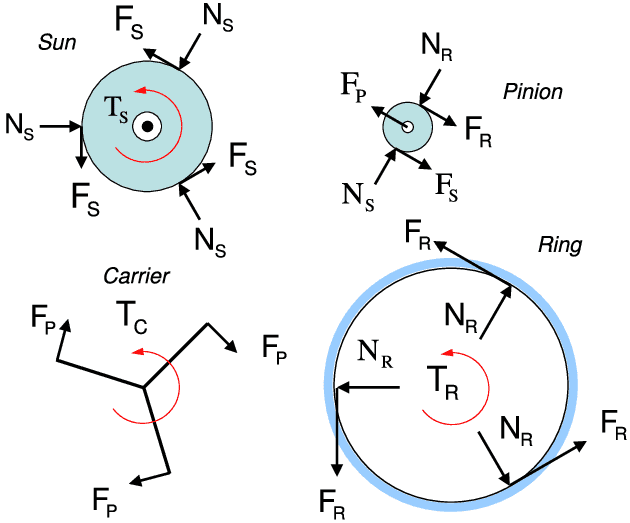

I am programming a vehicle for a company with as much realism as possible, but I have a little problem right now. I calculate the rolling resistance and the angular momentum. The problem is that I cannot calculate the longitudinal force, the lateral force as well as the slip ratio in order to be able to calculate the necessary torque.

It doesn't matter, you should be using equations representing physical systems. And in those, the weight is just a known parameter.
It is really about doing a free body diagram. One similar to the following one for a planetary gear set:
Just decoupled every component and do a force analysis on each of them.

I'm pretty sure the answer to your problem lies in a free body diagram. If you show us one that you've made, we can help you find mistakes in it, if there are some.

And, like @jack action said above, you NEED a free body diagram. After that is, you study the meaning of torque, momentum, and impulse (search those terms).
