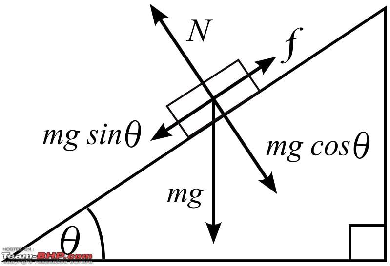

I want to calculate maximum gradient ability of my car in 1st gear to reach an estimation number.
The specification of the car is as follows:
Max torque = 155 nm @ 4250 RPM
Curb weight = 1200 kg
1st gear ratio = 3.454
Final Drive ratio = 4.52941
Tire radius = 0.298 (meter)
Acceleration force in 1st gear at max torque RPM (assuming 15% drivetrain loss) = (3.454 x 4.52941 x 155) x 85 / 100 = 6917 N
Can someone please help me to calculate the maximum slope (%) my car can climb with 6917 N force? How can I calculate rolling resistance and other negative forces?
What is the formula to calculate gradient ability?
I found this picture that may be helpful:
The simplest approach is to calculate the angle ##\theta## where ##mg\sin \theta = F##, where ##F = 6917N## is the maximum drive force, ##m## is the mass of your car and ##g## is gravity (##9.8m/s^2##). I get about ##36°##.
However, the other limiting factor is friction and whether you can generate that force on a sufficiently steep slope. Note that as the slope increases, so the normal force of the weight of your car on the ground reduces - it's ##mg\cos \theta##. That is a factor in reducing the maximum friction you have. In any case, if the maximum friction on a slope is less than ##6917N## then that's the limiting factor.

Hi,
I'm a physicist, no specific automobile expertise, but I want to bring in some physics nevertheless:
First, the dimension of your calculated 2061 is N.m. : the 155 is N.m and the other three factors are ratios.
Then: with a wheel radius of 0.3 m, this torque would provide an accelerating force of 2060 N.m/0.3 m = 6900 N.
Such a force, if it could be fully used for acceleration would make your car accelerate with 6900 N / 1300 kg = 5.3 m/s2.
Meaning you would go from 0 to 100 km/h in (100 km/h) / (3600 s/h) * (1000 m/km) / 5.32 m/s2 = 5.2 seconds. (the 1300 kg is curb weight + you).
Nowadays some (rather pricey) fossil fuel cars can do this. For electric cars it's easier.
Weakest link in the reasoning: unleasing the clutch at the 4250 rpm torque maximum.
Other issue: friction has to be enough (tires must not slip).

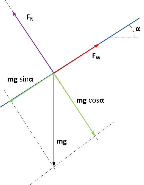

Transfer to hill climbing capabilities:
:wink:
FW is the maximum acceleration force available for the wheels. It has to overcome ##mg\sin\alpha##. So you would get ##\sin\alpha_{\text{max}}\ ##= 5.3 m/s2/9.8 m/s2 or ##\alpha = ## 33##^\circ##.
You would go up 65 m for every 100 m driven (##\sin\alpha##). I think they call that a slope of 65 % and I wouldn't think of even trying it with my car for fear of falling over backwards
Friction required: With ##F_{\text {friction, max}} = F_W = f F_N ## and ##F_N = mg\cos\alpha## you see that ##f \ge \tan\alpha = 0.65 ## is needed.
All in all: good question ! And fun. I hope some car buff has comments to improve the realism of these considerations :smile:

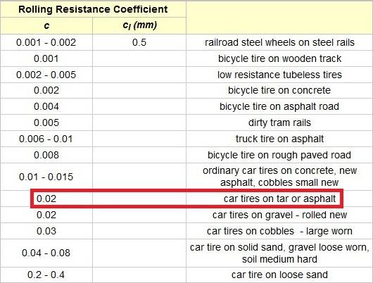

Thank you all for your responses. I also came up with 33 degrees but there are other things to consider.
As you said the main negative force here is mg* sin(θ).
I want to add some other forces to improve the precision of my calculation.
Since my car travels at only 29.5 km/h (in 1st gear @ 4250 RPM), air resistance can be neglected because the car is moving slowly.
However, I read somewhere that there is another factor called Rolling Friction.
According to the table below, we have to add 0.02 of Rolling Friction to our calculations.
I'm the driver of the car and I weigh 50 kg + 20 kg luggage at the back. So, the car weighs around 1270 kg.
Now, my question is:
How should I use that 0.02 in my calculations?
I will repeat the calculations and you can correct me if I'm wrong.
mg* sin(θ) + (mg* sin(θ) )*0.02 = ?
1270*9.81*sin(33) = 6785
6785*0.02 = 135
6785 + 135 = 6920 N
So, this is the negative force my car should overcome in order to climb a 33 degrees slope and since it has 6917 N of accelerating force, it can climb a little less than 33 degrees.
Am I right?

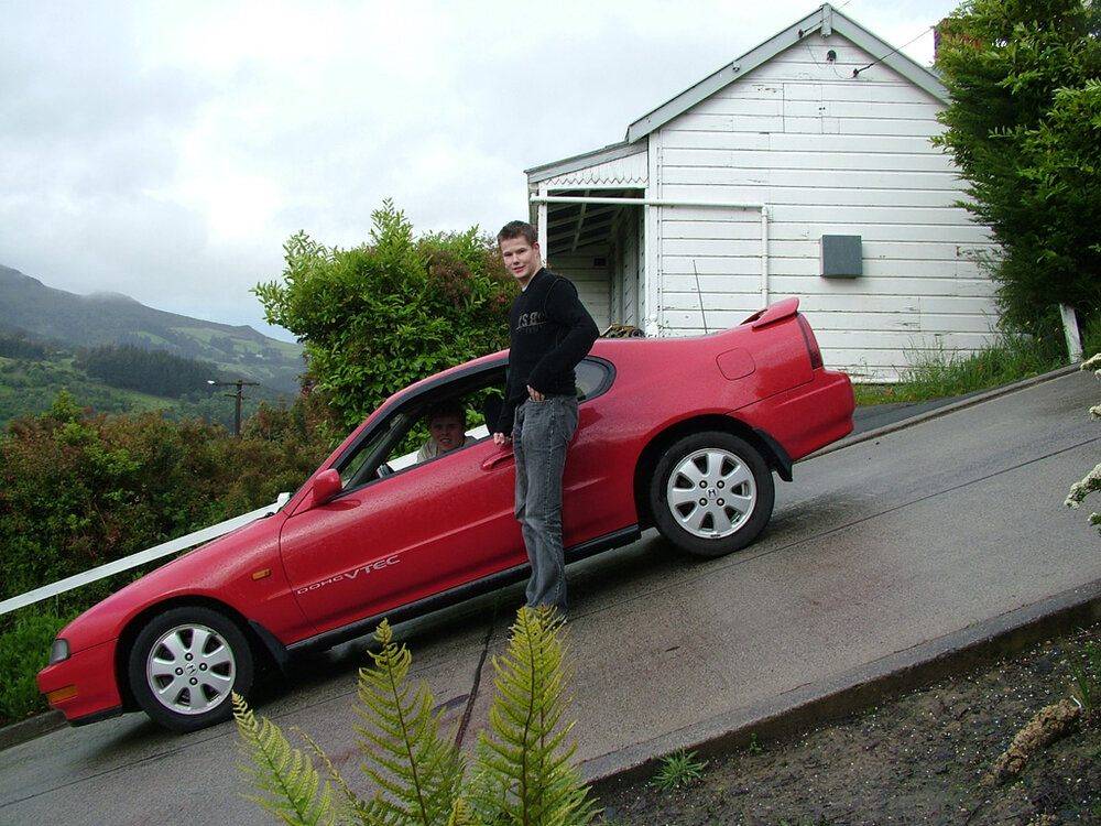

The steepest road in England is Hardknott Pass in the Lake District. It's narrow and rough as well. Never again!
Baldwin street in New Zealand holds the record for the steepest road in the world with a slope of 34.8% (19.2 degrees).
  • Wow
These calculations are not precise enough for rolling resistance at 2% to be a factor. The margin of error is significantly more than that. I would expect air resistance, even at low speeds, to be at least as significant as rolling resistance.

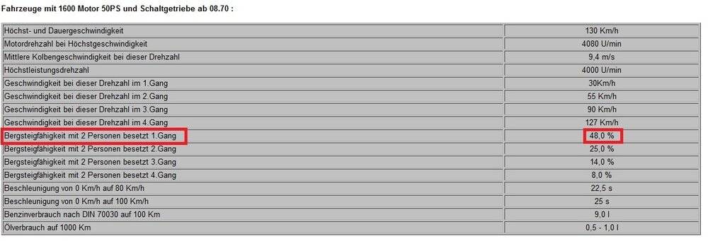

I think these calculations are not far from truth. I tested them against official data published by well-known car manufacturers and I almost ended up with the same result!
This is an example:
Volkswagen has claimed that VW Beetle with 1600 cc engine can climb a 48% slope in 1st gear (with 2 people onboard).
Engine torque = 106 nm @ 2800 RPM
1st gear ratio = 3.80
Final Drive ratio = 4.125
Wheel radius = 0.3145 (meters)
Curb weight = 870 kg
Now, I use my own calculations to see how close I can get to the official 48% slope.
(25.64 degrees)
Drive force = 3.80*4.125*106 = 1661.55 / 0.3145 = 5283* 85% (15% drivetrain loss) = 4490 N
Car weight = 870 + 160 (2 passengers) = 1030 kg
mg* sin(25.64) + (mg* sin(25.64) )*0.02 = 4459 N
4459 N is pretty close to 4490 N
That's very well done! I suspect VW have done what you did and calculated the theoretical maximum gradient in each gear.
That is true for an AWD. It is less for a RWD or a FWD. (details)
It's all worked out in the link I gave. I especially liked the last sentence

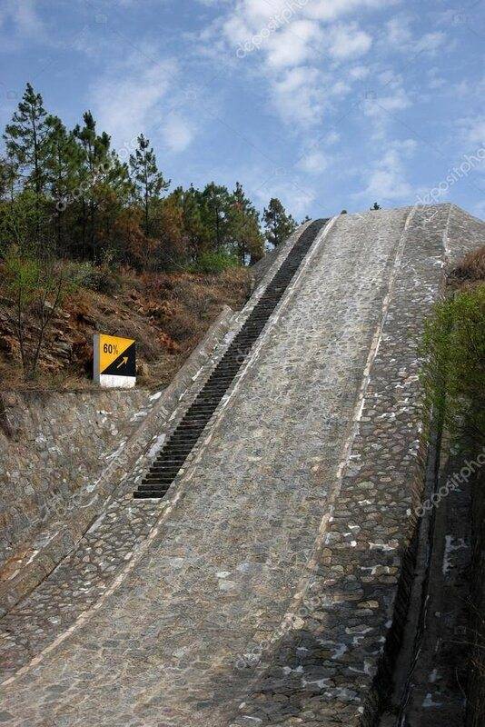

This is what a 60% slope looks like:
But in practice, it is not easy to climb such a steep road because even if you have the power, the weight of the car will shift to the rear axle and front axle will get lighter. The result is lower traction of front wheels and wheelspin (FWD). However, this condition may benefit RWD cars because the weight transfer increases traction at the back.
If the problem of traction (friction) can be solved, some extraordinary results can happen like this Audi which is climbing a 85% slope on a snowy surface!

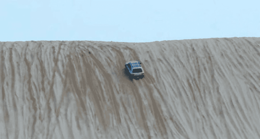

And then we have those who do it in competition. The car in that picture is a Subaru Forester.
