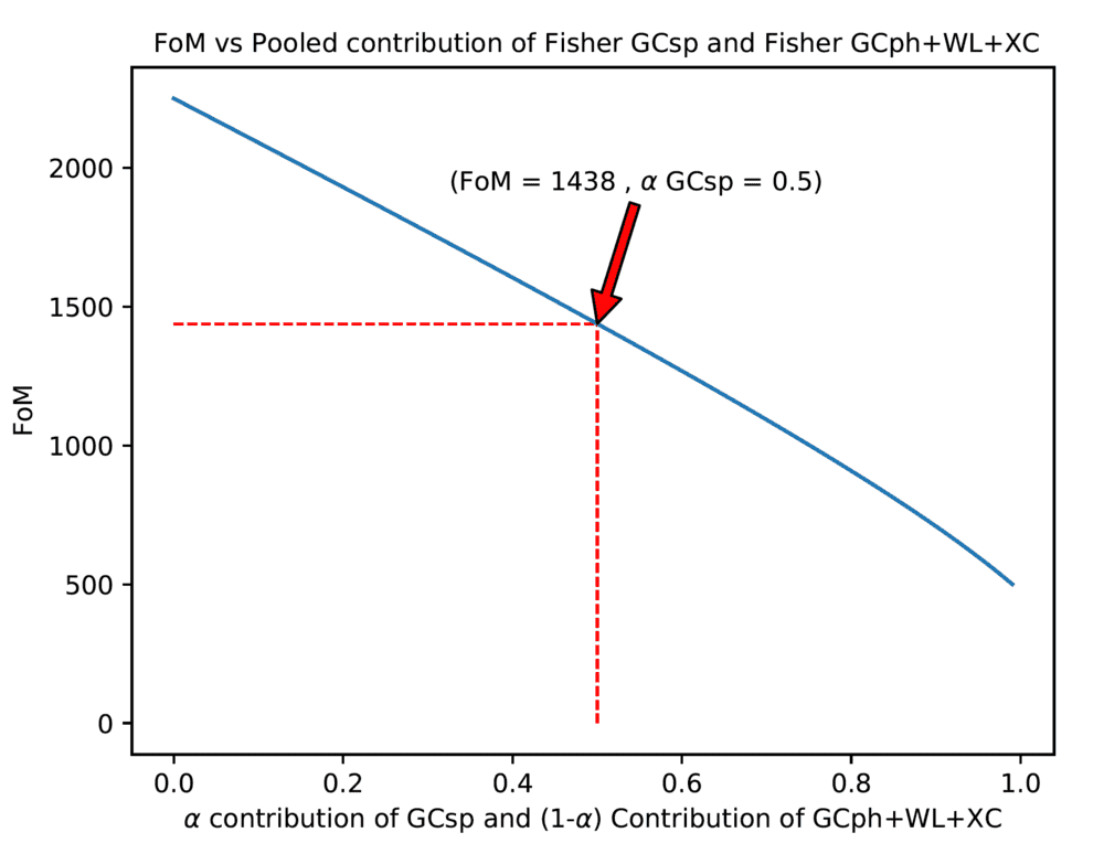

I make following to the point where I was up to now.
The goal is to combine the informations contained into 2 different Fisher matrix to get a cross-correlated unique Fisher matrix. a friend suggested me to take the average of each diagonal of diagonalised matrices and do the sum of the 2 new Fisher matrices. This is called "the pooled variance/covariance" method.
I have firstly applied this average contribution and obtain better constraints on my parameters (by taking the inverse of final Fisher matrix). The amount of accuracy is determined by the "FoM" quantity : the more is high, the smaller are the constraints.
Now I would like to refine the criterion for choosing this value corresponding to the average, i.e by applying a `0.5 factor on each diagonal matrices elements. (above, the relative factor of contribution = 0.5 for each diagonal matrix).
For this, I have covered all the possible contribution by making vary the "alpha" quantity comprised between 0 and 1 and that represents this relative contribution between the 2 diagonal matrices.

Below a figure showing the results :
Line plot titled "FoM vs Pooled contribution of Fisher GCsp and Fisher GCph+WL+XC": FoM decreases from about 2250 at alpha 0 to about 500 at alpha 1. A red dashed guide marks alpha = 0.5 at FoM = 1438.
If I take alpha = 0.5` (as suggested by a colleague when he talked about taking the average), I get a `FoM = 1438`.Another result obtained by a different method (from physics hypothesis and not mathematical like here) gives a `FoM = 1567 : we are pretty near to a same result (mostly, constraints derived from these 2 FoM are closed, so consistent).
This is better than my previous constraints but I would like to know why can't we choose another value for `alpha` parameter and mostly, which criterion could I choose to be as possible as it can to do a right choice for this parameter.

Anyone could help me to find a criterion for the choice of alpha parameter value which is justified in the combination of my 2 Fisher matrices from the figure above instead of simply taking the average of the 2 diagonal matrix, i.e taking alpha = 0.5` ?
Have I got to study the heterogeneity of the 2 Fisher matrices (or covariance matrices) and if yes, how to perform this study ?

The main argument I have seen on "alpha=0.5" choice is that first Fisher matrix brings as much as second Fisher matrix from a Fisher's formalism point of view : what do you think about this argument ?
