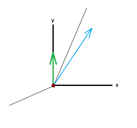

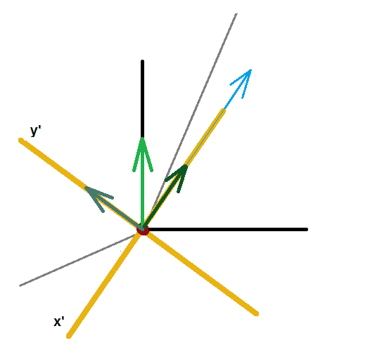

Okay, so kinda zooming into one of the velocity vectors on the graph of the post above...
following up on this question, can you tell me if these statements I'm making are accurate:
If the acceleration vectors are to point vertically at 90 degrees, that would mean there is no x component of acceleration, right or wrong?
However, the path of the object described by the position functions in the first post's graph is in a curved trajectory. Thus it must have a centripetal acceleration, yes or no? And that centripetal acceleration is ALWAYS supposed to be exactly perpendicular to the velocity vector, correct?
And centripetal acceleration is defined as a component of total acceleration. And if the vertical acceleration in the above graph is defined as total acceleration, then it does in fact have a component called centripetal acceleration.
And the other component of total acceleration would be parallel to the velocity vector.
So while total acceleration is completely vertical, thus not having any components on the x vs y axis, it does have components on a different set of axis that run parallel and perpendicular to the velocity vector. So there are two sets of axis to consider when evaluating/examining velocity vectors, the x y cooridinates and the x' y' coordinates.. Would this be right?
Just in case it's not so clear, the two graphs in the above post (post # 3) are supposed to represent zooming into one of the velocity vectors on the graph in the original post (post # 1)...and with that in mind, hopefully I can find out if any of the statements I made are right or wrong, and thus being able to pin point any portion of acceleration I may still be confused about.
So if anyone can tell me if I'm confusing any details here, i'd really appreciate it.

Yes, it means that the x-component of the acceleration is zero at least for that moment in time.
Yes, if by that you mean an instantaneous centripetal acceleration for the given instant of time, and it is with respect to the instantaneous radius of curvature for the curve at that point and instant of time.
That is true, yes. Note that there may be other acceleration, too. In keeping with the notion of perpendicular coordinate systems and therefore perpendicular vector components, there could also be a "linear" acceleration tangent to the curve at that that same instant. If centripetal acceleration is constant and non-zero for all time, and linear acceleration is constant and zero for all time, then you have true circular motion.

Again, centripetal acceleration is a component the acceleration as judged from a different coordinate system. One doesn't usually want to mix them all together in the same bag without careful consideration of how the various coordinate systems are related. The instantaneous total acceleration can always be had by adding together the component vectors in a given coordinate system. But that is the total acceleration as expressed in that coordinate system. You would have to know how to convert from one coordinate system to another to express the same vector in another coordinate system.
