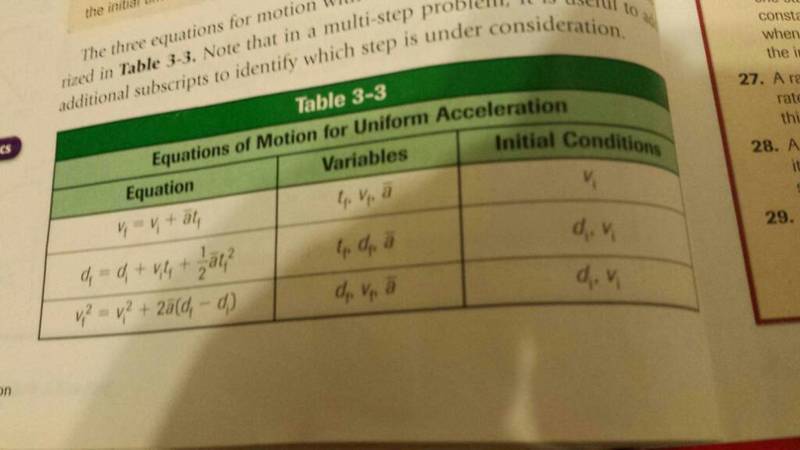

The second one? Df=...
Yes, but you would have to restart the application of the equation after the first 5 seconds, so d in the equation would be the distance relative to the location after 5 seconds, and t in the equation would be 0 at the running time of 5 seconds.
Hope this makes sense. Now, what do you get?
Chet
So we r starting new after 5sec? Df=100 ,vi=20, tf=0 ,a= -6 substitute these numbers?
Wait no,,, di =100 , df is unknown
..wait ..so since I am starting another one,, everything before 5sec doesn't matter,, so my vi is not 20m/s anymore?
You seem to be pretty confused. But, you are beginning to get the right idea.
I might be better to think of this as two separate problems:
Problem 1:
Applies between time 0 and 5 seconds
Initial distance = 0
Velocity = 20 meters/sec
Acceleration = 0
You have already solved problem 1 correctly
Problem 2
Applies after 5 seconds
Initial distance = 100
Initial velocity = 20
Acceleration = -6
You need to modify your equations a little to handle this part:
v = 20 - 6t'
d = 100 + 20t'-6(t')2/2
where t'=(t-5)
So,
v = 20 - 6(t-5)
d = 100 + 20(t-5) - 6(t-5)2/2
Do these equations make sense to you?
