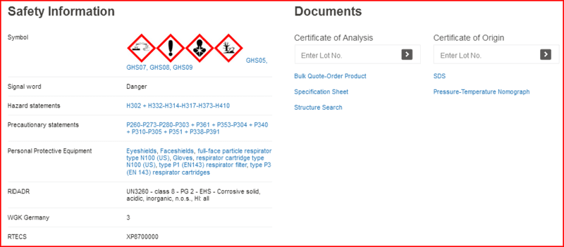

What is your background in handling chemicals? Have you read the MSDS for tin chloride and the components you want to use to synthesize it? What kind of a lab will you be using, and what PPE will you be using?
https://www.sigmaaldrich.com/catalog/product/sial/452335?lang=en&region=US
MSDS: https://www.sigmaaldrich.com/MSDS/M...drich.com/catalog/product/sial/452335?lang=en
i need this solution to try to do silvering of a plastic surface for my hobby project
the tin solution in this case will be used as 'sensitizer', i.e. it willbe used to prepare the surface to be silvered...
i have only a scholastic background, not a professional/expert background
thank you for the link and the safety sheet
