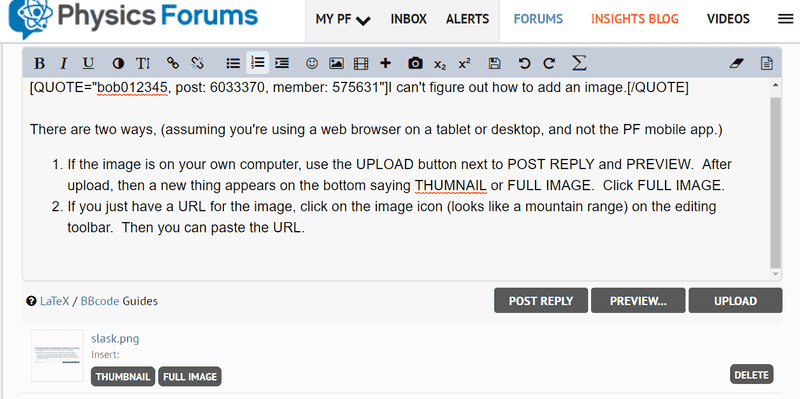

bob012345 said:
I can't figure out how to add an image.
There are two ways, (assuming you're using a web browser on a tablet or desktop, and not the PF mobile app.)
  1. If the image is on your own computer, use the UPLOAD button next to POST REPLY and PREVIEW. After upload, then a new thing appears on the bottom saying THUMNAIL or FULL IMAGE. Click FULL IMAGE.
  2. If you just have a URL for the image, click on the image icon (looks like a mountain range) on the editing toolbar. Then you can paste the URL.
