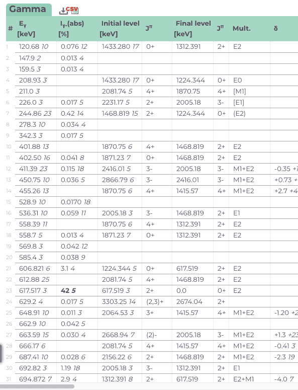

I was looking at the decay scheme (https://www-nds.iaea.org/relnsd/vcharthtml/VChartHTML.html) of ##^{112}Ag## which ##\beta##-decays to ##^{112}Cd##. ##Cd## is most likely left in an excited states, so it decays to its ground state by ##\gamma##-emission. As you can see there are tons of possible energy levels, so there are tons of possible gammas. If I were to measure those gammas with a scintillator (with not very high energy resolution) which one would give me an observable peak ? I can't figure this out...
For example, take the first one (in the gamma-table): I have a gamme of energy ##120keV## emitted by the transition from the level with energy ##1433keV## to the on with energy ##1312keV##; it says ##I_{\gamma}(abs) = 0.076 \space 12## but what is it ? Would it be detectable ?
Thanks in advance.
It says 617.517 keV and 42% under "major radiations". That's what you should look for.

Sorry, but where did you find "major radiations"? Anyway, the 617.517 keV gamma is the one with the highest ##I(abs)## which is exactly 42. So I just have to look for the highest value of ##I(abs)## ? (I'm referring to this table)
Table of gamma-ray transitions with columns for E_gamma (keV), I_gamma(abs) (%), initial and final level energies (keV), J-pi, multipolarity and delta. Row 23 lists E_gamma 617.517 with I_gamma 42 5.

Hover over the nuclide.
