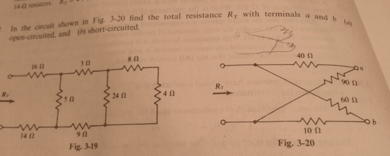

See pic for problem statement and diagram (we are dealing with the diagram on the right)
http://i.imgur.com/Uv7Ikma.png
I'll rewrite the problem statement here if that helps: Find R_T in the diagram for the cases where ab is open circuited and short circuited.
And its solution in the textbook: The first part of is part a) the second part b)
http://i.imgur.com/yYLGoFE.png
Why is it that after combining the top two resistors and combining the bottom two resistors in the picture that the two resulting series combinations are parallel to each other?

To avoid errors like your last picture (*), you can flip the 90 Ω and 10 Ω resistors from left to right with the line ab as axis. The it becomes clear that 40 and 90 are in series, as are 60 and 10 (case ab open).
(*) you draw a circle around a non-connection and move it to the top left as if that were short-circuited too (that would yiled RT=0 !)

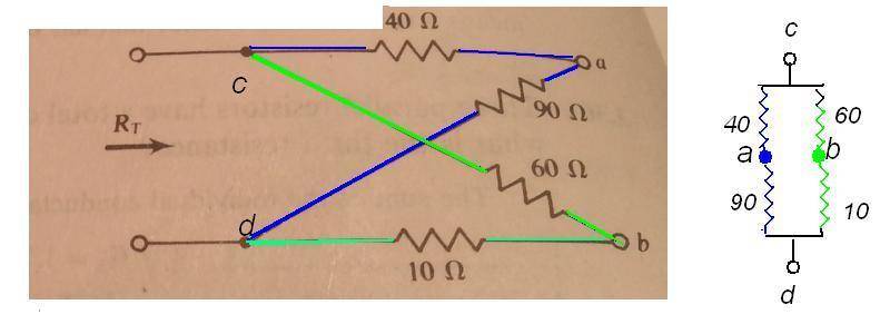

You can walk from c to a and then from a to d (blue path). If nothing else is connected to a, the 40 Ω and 90 Ω resistors are connected in ?
You can also reach from c to d along the green path. If noting is connected to b the 60 Ω and the 10 Ω resistors are connected in ?
So you can redraw the circuit as in the picture on the right.
What happens if a and b are short-circuited?

You can walk from a to c and then from c to b (blue path). If nothing else is connected to c, the 40 Ω and 60 Ω resistors are connected in ?
You can also reach from a to b along the green path. If noting is connected to d the 90 Ω and the 10 Ω resistors are connected in ?
What happens if c and d are short-circuited?
I just want to confirm that the intersection X of blue and green and in circuit diagrams in general does not mean there is a physical intersection. Am I correct?
So like the blue could come out of the page and the green could go under the page?

Yes

There is no physical intersection in the middle of the drawing. If it was, it would be drawn by a circle, as it would be a node.
Yes, the lines can go one above and the other below the paper.

Sorry, I misread ...I attached a corrected picture. I hope, it i right now.

Sorry, I misread the problem. I corrected my original post and picture. The problem means a and b short-circuited. You have to find how the resistors are connected with respect to the terminals c and d.
