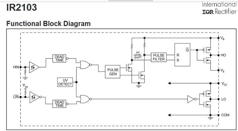

I need to know how to ocsillate the current between +55v and reverse. I have been advised to use multiple IR2103 half bridge drivers in conjunction with an arduino and 4 digital pins need the guidence to setup this circuit. Can anybody help. The more help I get the easier it is to understand the manual!
I am designing a machine that puts out constant ,and I want to put it through an H-bridge style setup to reverse the polarity at 50hz, by utilising IR2103 half-bridge's and arduino. after hat the 55v at 50hz will excite a transformer with turn ration 4.182 to achieve approximately 230v ac. thanks for any help in advance!

I can see that you don't want to part with your knowledge. I understand the not gates and nor gates I don't know what UV means and I don't know what dead time means. I understand the pulse generation and how it works, I understand the internal transistors and I understand the pulse filter, so there's a lot I do get. I just need some help I have a gcse in electronics and a level 3 diploma in electrical and mechanical engineering. and ok another approach can you tell me where I can get the information I need that explains how to get the desired ac at 50hz 50% duty cycle

Why do you not simulate the circuit with LTspice?

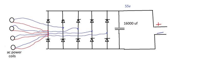

ok so another approach can i just BUY an inverter that takes an input of 55v?
There is still an elephant in the room.
How much current can you draw from the 55 volt supply before the voltage falls below 50 volts?
You need to know that before designing or buying an inverter.
ok I next go to work on it for 2 hours on friday. I have two meters, my four coils are connected to a 10 diode bridge similar to this. I still need to do that check, I will be using two multi meters at the same time one measuring votage accross the output, and the other in-line with a power resistor of 27 ohm 100w to give current reading and I do realise that if I dont want to blow the power resistor i can only run it up to 50v because 50/27=1.185185 and then for power multiply current by voltage eg 1.185185*50 which equals to 92.approximatly, I think max I can do it 52v, but in reality when I tested for current, I was getting up to 70 amps, so yeah I need to the voltage check on one multimeter and current showing on the other at the same time, cheers

and ok say i find this time that the voltage drops from 55 to 50, then what procedure do I do to choose something adequit ? method?
