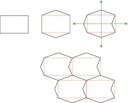

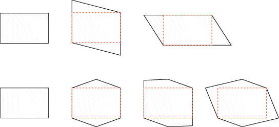

You mean you want to symmetrically edit the 2 opposite corners of a square...?
Just noticed my error...Edges and not corners, my mistake...!
Essentially you are producing a Hexagon and can use the Polygon tool to produce a shape with a number of sides, in this case a Hexagon, 6 sides and rotate 90 degrees. There's also the, Warp Tool, you could use to turn the square into a Hexagon shape
To do the same as the video.
1. Turn on smart guides [Useful when precision is required]
2. Draw a Square
3. Select the pen tool
4. With the square selected, now move the pen tool to the centre of the square, also the rotational axis. When you've done this, the pen tool will highlight some text telling you, you are; Center, Align 0 degrees, etc.
5. Once you are on the centre move the cursor down slightly and a smart guide is automatically placed at 90 degrees through the centre of the square [Move off that 90 degree axis and the guide will disappear or show a different angle]
6. Follow that 90 degree guide and the point it intersects the edge of the square, again the programme will indicate you are at a point of intersection [Intersect] and using the pen tool, create an Anchor Point.
6a. Follow the same guide and create another Anchor point at the top edge of the square
7. Use the Direct Selection Tool [Clear Arrow] to select the 2 new anchor points.
8. Select the Scale Tool [Arrow inside a rectangle] and move to either the top or lower Anchor Point
9. Move either point up or down...!
If you've done this correctly you should see the square change shape into a hexagon...Next step is to filet the corners
Hope this helps...
I don't know what he wants. How hard can it be to actually describe? Yet he refuses.
From his original post he's described a rhombus and from his second post with the video a hexagon, apart from that I would not like to say...!
What is interesting is, slightly O/T. With a symmetrical edit on the Y axis and a non symmetrical edit along the X axis you have the start of a Tessellation.
