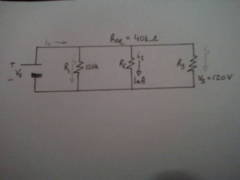

Find all the unkown R,I's, V's
Reg=(R1*R2*R3)/(R1+R2+R3)
it=i1+i2+i3
V=IR
All unknowns:
R2,R3,i1,i3 it,Vs,V1,V2
It seems that I need one more bit of information to solve any variables
i1 goes across R1, i2 goes across R2, i3 across R3
Hint: Since the three resistors are in parallel, what's the voltage across each? (And the battery voltage, for that matter.)
Since they are parrallel the voltage across each is equal to each other? Vs=V1=V2=V3 is this right?!? Also why is that?
