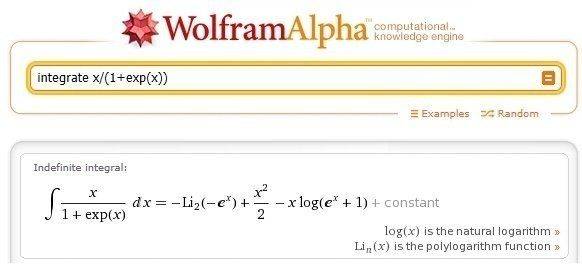

∫ x / (1 + ex) dx
please help me to solve this.. :)
You can't solve this. This integral cannot be solved in terms of elementary functions. Specifically, you need the polylogarithm to solve this.

but if you want to.. can you show how to solve this by using the polylogarithm? :)

What do you mean by that? "Integration by parts" is a normal integration method. And won't work here. As micromass said, that cannot be integrated in terms of elementary functions.

If you know the polylogarithm functions, then the formal result is :
  • Wolfram Alpha screenshot: query 'integrate x/(1+exp(x))' with indefinite integral result -Li2(-e^x) + x^2/2 - x log(e^x + 1) + constant, plus notes defining log and polylogarithm Li_n.
