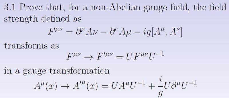

Printed text stating a problem: prove that for a non-Abelian gauge field the field strength F^{μν} = ∂^μ A^ν - ∂^ν A^μ - ig[A^μ, A^ν] transforms as F^{μν} → F'^{μν} = U F^{μν} U^{-1} under a gauge transformation, with A^μ → A'^μ = U A^μ U^{-1} + (i/g) U ∂^μ U^{-1}.
I am learning QFT, and I am confused of such transformations. For example, first, in these equations, especially the one that defines the transformation of A(x), whether should the partial derivative acts on U(or U-1), or just take U as a constant? Second, the partial derivative acts only on U-1 or all the things after it?
Another question is should we consider A(x) and F(x) as an operator, so that when calculating, it is convenient to put a function after it.

I am not sure about your background but if you want to show it then you can take a simple say SU(2) model,and note that the U's are not constant .In most representation it can be modeled as,U=exp(ζata).you can look up here for this and most noteworthy is chriss quigg book on every kind of interactions.

You mean that, for example, in the last equation of transformation for A(x), the partial derivative should act on U-1, rather than taking U-1 as a constant?

Yes,of course because U used here as a local gauge transformation.the transformation of gradient takes the form
∂μψ=U∂μψ+(∂μU)ψ
For the derivation which you are looking for,I will refer you to chris quigg book on'gauge theory of strong,weak,electromagnetic' page 55-60.I am not going to derive it here because as always I am out of time.
