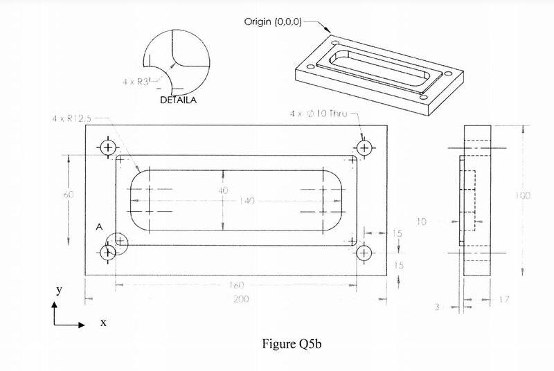

Hi, I just learnt fundamentals on programming G-codes
Does anyone knows how to write g-codes for this component? I am wondering how to do the island (iii) and pocket (iv) parts with fillets.
Appreciate a lot if someone could save me from this :))

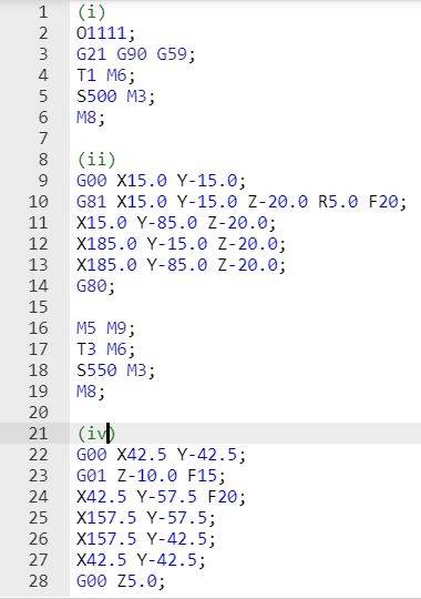

Can you show us how you did parts (i) and (ii) so far?
Okayyss noted.. I wasn't aware of the rules. I am so sorry about that😅
Yes, I have tried to do the parts (i) (ii) and (iv). Left part (iii), because I have no idea how to do the fillets.
But I am not sure are they workable or not.
