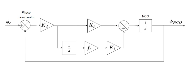

Find the relationship that gives Ki as a function of all the parameters to obtain the correct impulse response
at a phase step regardless of the rate and the number of samples per symbol
H(s) = (Kd(Kp*s + Ki)) / (s^2 + Kd(Kp*s + Ki))
Kp = 2*Xi*wn / K
Ki = (wn)^2 / K
Hello everyone, it's not really for my homework (because I'm not at school anymore) but I'm new and I don't know how to start a new forum. I've never done automatic before and I need help.
I have a 2nd ordre PLL on MATLAB, with an NCO and a PI corrector; the PLL works via the Mid/End algorithm (that's part is ok). I need to find the link between the theoretical formulas and their values in the code to find the value of the gain Ki, and possibly that of Kp if it's not correct. Unfortunately, I can't find the formulas so that my gains are always adapted when I change the rate or the number of samples per symbol, while I'm sure that it exists. Xi and wn are fixed. I thing the problem is K (Kd * Knco), which must not be correct, but I know that sum(g) is.

I hope I'm clear. Please, be nice with me, English is not my native language and I don't know a lot about PLL

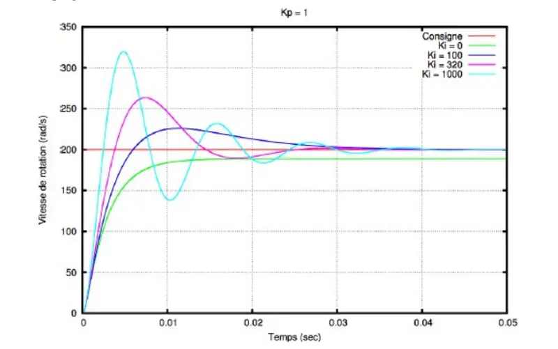

Sorry, I have no desire to troubleshoot your code, especially with no comments. But I'll comment a bit on the sampling problem. The linear system you've described is in continuous time. When you sample it, you are adding a zero-order hold function with the time delay between samples (there are others, but this is the most common and simple). This has to be added to your model. A change in the sample time will directly effect the integral and derivative gain terms. This is pretty basic digital control stuff, so there's a lot of information on the web about it. Look up digital PID controllers, digitizing LTI systems, also discretization.
Here's one of many: https://www.controleng.com/pid-correction-based-control-system-implementation/
