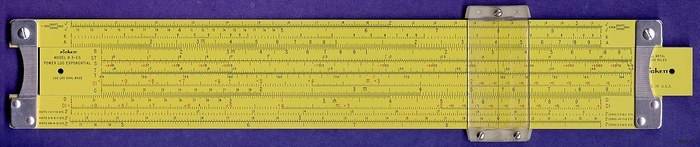

Before electronic pocket calculators became common, every engineering student owned one of these ...
http://en.wikipedia.org/wiki/Slide_rule
Yes, but you needed to know the value of the logarithms in order to make a slide rule.

If you needed more then the 3 digit accuracy of a slide rule you opened a book of log tables. We were even taught to do a linear interpolation to get values between tabulated values.
