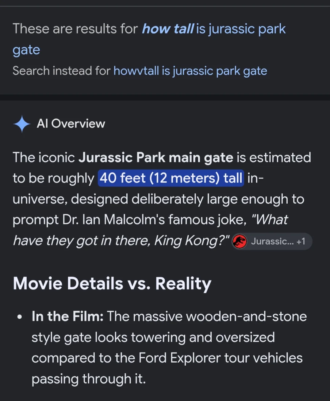

OliverStJohnMollusc said:
i am trying to build a lifesize replica of the jurassic park gate
It's forty feet tall, fer cryin' out loud!
