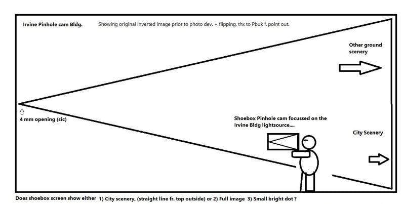

ndvcxk123 said:
Thx for the corrections. Amazingly, looking through my own pinhole shoebox ab. a month ago, I did not remember it being inverted. (Hence the diag. error). Re focusing, it is interesting though, that it become less sharp if the aperture is widened (due to addit. light entry).View attachment 329844
There's a problem with that diagram. It appears that the small camera is actually looking at the front of the big camera, which has just a small bright spot in it. The brightness of that spot corresponds to the brightness of the scene in that direction.
We (or at least some of us) may have been talking at cross purposes. What was the actual question - in the light of that possible mis-understanding?

The fundamental misunderstanding in this thread is manifest in the title. The Huyghens construction (and in fact any diffractive effect) has essentially nothing to do with this analysis because of the sizes involved. Strictly Ray optics... one needs only a ruler and notion of aperture area. All else is irrelevant.

But getting the picture the right way round is pretty important. What is he trying to image with the small camera? Is it an image of a pinhole or an image of the large camera image? This is not a mere detail imo.
Or even the scene with the first camera absent. From what I can gather, he seems to want to try all 3 cases, and see if there is something of interest for each.

From the article linked in #1:
A seamless piece of muslin cloth was made light sensitive by coating it with 21 US gallons (80 l) of gelatin silver halide emulsion and then hung from the ceiling at a distance of about 80 feet (24 m) from a pinhole, just under 6 millimeters (0.24 in) in diameter
From the aperture size calculator linked in #33:
Focal length of camera in millimeters 24000
Optimal pinhole size: 5.7... mm
But none of this affects the key point that the image you get can be simply determined by ray tracing (it just means that the image is blurred due to (1) rays from opposing extremes of the aperture hitting the screen at different points and (2) individual rays forming diffraction patterns. The smaller you make the aperture the better you make (1) but the worse you make (2) as well as image brightness (increasing exposure time), and vice versa.
Well, was not sure what the result would be....

Well, I wondered whether sampling with a small aperture might recreate the full wave entering...
You would need to explain that more fully. I have made assumptions:
There is a tradeoff between aperture and resolving power. The smaller the aperture, the wider the diffraction pattern. Assuming you could describe the resultant wave from light entering from all across a scene then a tiny aperture would not allow discrimination between light from all the different elements of the scene. So you'd just get a (slightly weighted) value at one emerging angle from your small aperture which is a sum of light flux from all different directions.
The nearest thing to the "full wave entering" would be obtained with a massive aperture.

Re learning curve: After constructing first pinhole shoebox cam, find that it works, but I'm running out of breathing air quickly closing black coat around it + my head ! :) The other aspect interesting me is image reflection w. out a lens, bec. still, from the middle of the image there are just slightly diagonal lines which should cover the other middle objects. However, pinhole images, while weak, are still really precise. To me, that's surprising.
