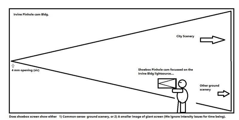

The Irvine Giant Pinhole Box generated a ~40m landscape image w. a 4mm hole. Q. is on effects of directing another small pinhole box at the lightsource, while standing in lower part of scenery.
The image generated by the Giant Irvine pinhole cam is a landscape, with features in top of image and ground/water image on the bottom. Now, directing a small shoebox-type pinhole cam at the lightsource while standing only in the lower part of the image (no bldg. features visible there or projected against the user), what does the mini-screen of shoebox-pinhole show ? 1) The ground features only, not the upper part of the giant image, bec. those light portions do not reach the box, or 2) (Huygens?) - a small version of the entire image, including the bldg.detail features in the upper portion ? Thx.

With a pinhole camera, you get a geometric image=light travels in straight lines, (from the source, through the pinhole, and on to the screen).
Diffraction effects with a very small aperture can make for some blurring, but if the pinhole is too large, you also get reduced resolution, because of blurring determined by a point source making a finite sized spot from geometric optics when the aperture is finite. In general, there is an optimal aperture size, where diffraction effects are minimal, and where the spot size from a point source using geometric optics (i.e. using the straight line principle=the aperture shows up on the screen, etc. using ray tracing ) is also reasonably minute.
To add to the above, you do want to have the pinhole large enough that sufficient light gets through to generate the image, but not so large that the resolution is considerably reduced by having point sources whose image becomes a somewhat large circular spot. Ideally you want the image from a point source to be a very small circle=nearly a point.
Note that the energy that gets through the pinhole to create the image is proportional to the area of the pinhole.
If I understand the question, you stand inside the large camera holding a small pinhole camera. In this case, from geometrical considerations, you will form a tiny image of the portion of the scene seen through the 4mm hole, and it will be little bigger than the pin hole. And in addition, the resolution will be softened in the ordinary way by the finite diameter of the hole and by diffraction created by the aperture. The brightness will be very low and I am not certain that anything would be visible.
You will form a small small dim image of the spot and whatever may be in the line of sight of the spot in the harbor. It will not be useful.

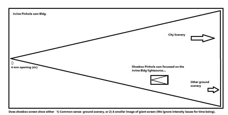

My diagram was weak, here it is with the observer, sorry, + thx. You said " would give without the "big" camera except that the big camera occludes all but a tiny 4mm spot. " (Endquote) - So, observer is inside the "Irvine cam" (building) - we are not comparing the two, separately, but one inside the other, w. the observer at the screen side of the small-shoebox pinhole. One barely even sees the 4mm pinhole of the room, and the image they created may have been developed over a longer exposure (I don't know). But assuming similar screen composition/chemicals in the mini shoebox, very weak light is still entering it, though I believe it would just be of the ground scenery, not the top. BTW, I built a shoebox-size pinhole box, + was shocked at the clarity of the image.

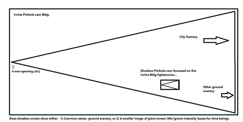

Thx so much for sticking w. the topic. For clarity below the observer can now be seen in the diagram.
Re straight lines, was "hoping" for a "wavelet" effect where the light at the bottom somehow still has all the info + creates new wave triggered by the aperture :) :). Thx!

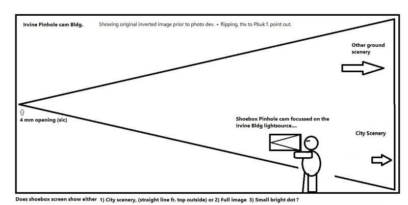

No pinhole has any "image creation effect", all the pinhole does is block light from most of the outside world from reaching the screen. If you draw a straight line from a point on the screen through the pinhole you will see where in the outside world that light has come from.
For your smaller camera, you need to draw a straight line through both pinholes to work out what light gets to what part of the screen (if any).
Also note
  1. Your labels "city scenery" and "ground scenery" are the wrong way round: pinhole camera images are upside-down.
  2. The word "focussed" is incorrect here, pinhole cameras do not focus anything.

No, the image generated by a pinhole camera is inverted. The image now displayed in the warehouse is hung the other way up from the way it was created.
To the OP: You are looking for some kind of magic to occur with two pinholes, and it just doesn't happen. If the hole is small enough in the second pinhole, you can get diffraction effects=especially if you have a bright source like the sun in the line of sight of the two pinholes. Then you could get a ring pattern (the light is not monochromatic though), but you could then get an airy disc type diffraction pattern, instead of a small bright spot on the image screen of the smaller camera. (The smaller the hole, the wider the ring pattern). In any case, you will not magically get the image of the whole scene to appear. The light needs to go through the two pinholes, and neglecting diffraction effects, it travels in straight lines.

Thx for the corrections. Amazingly, looking through my own pinhole shoebox ab. a month ago, I did not remember it being inverted. (Hence the diag. error). Re focusing, it is interesting though, that it become less sharp if the aperture is widened (due to addit. light entry).
