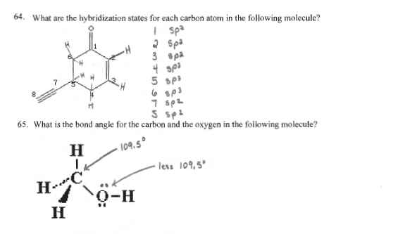

  • One participant questions the accuracy of their teacher's classification of hybridization for carbon atoms 7 and 8, suggesting they should be sp instead of sp2.
  • Several participants agree that the hybridization for both carbon atoms 7 and 8 should indeed be sp.
There appears to be agreement among some participants that the hybridization for carbon atoms 7 and 8 should be sp, but the initial question indicates uncertainty regarding the teacher's classification.

Hi, in the link above, I am looking at the 1st image.
This is the answer my teacher offered, but at 7 and 8, shouldn't the hybridization be sp, not sp2?
We did not cover this topic in class, and I am kind of shaky on the topic.

Please upload the file to PF.
Uploaded
sp for both 7th and 8th.
Indeed, 7 and 8 should be sp.
